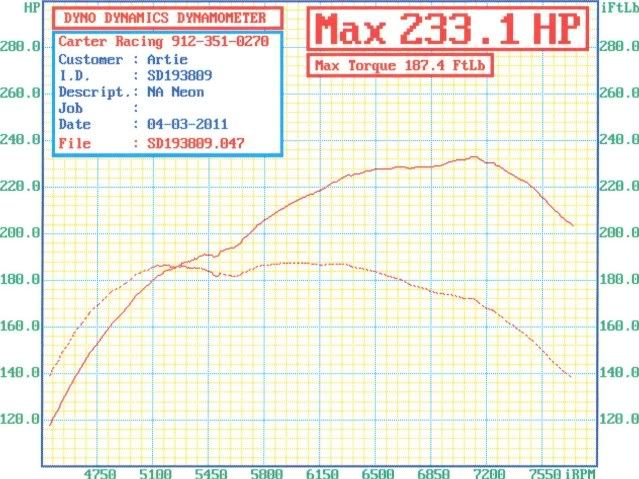

We first ran the car with the box (caravan) manifold. The switched to an ITB set up.
We saw a 10 HP increase through out the range, and an almost 10 foot pounds of torque with a broader flatter curve.
This was a Dyno Dynamics Dyno I don't know how to compare it with a Mustang or a Dynojet
Art Leong 2095 SS

Id say no matter what they read thats a good gain Art! Dyno dynamics read like a Dynojet from what Ive seen. Specifically the models that bolt to the hub instead or running on rollers.
