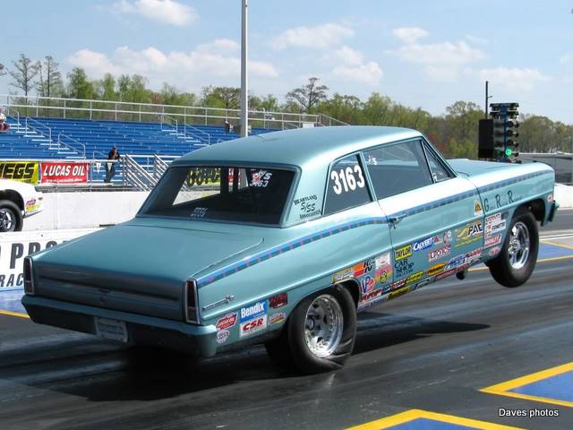

jims car works great with the m/t. ya think.

We run the MT 9 x 29.5 part# 3056ST. We run them down to the wear bars and they are good the whole way. Pretty nice. The MT trailer is at a lot of IHRA and this year back at NHRA points meets. Check their schedule out.
http://www.mickeythompsontires.com/event_link.php
If you have any specific questions, please shoot me an e mail jimschaechter@earthlink.net
Always good to talk to another Stick racer. Jim
