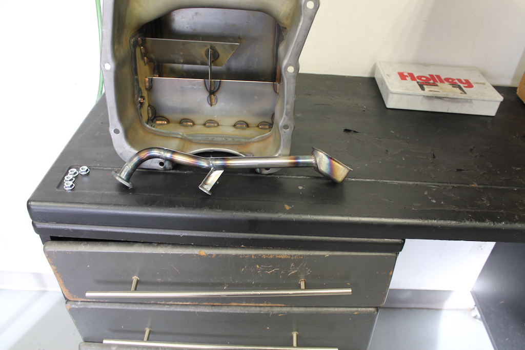

After racing the Buick, the first time in competition I noticed the car would lose oil pressure during hard braking in the lights, so I had my fabricator modify the factory oil pan for more capacity and better oil control, although its not finished yet here are some preliminary pictures.

Default Re: 1971 Buick 455 GS F/SA G/SA Build
i was not aware we could modify the oil pans that much
Mines mild from what I've seen. But, when 4 different people tell you its not legal its time to go back to the drawing board.
You can't .....these pics only belong on a thread dated April 1st....
Superstock oil pan?

Originally Posted by Shadylane View Post
Is that the date when the new rule comes out stating that we can run any oil pan or dry sump in stock... In the name of safety of course!
Yes, you are correct. I believe the info came from Fred Rector.....
