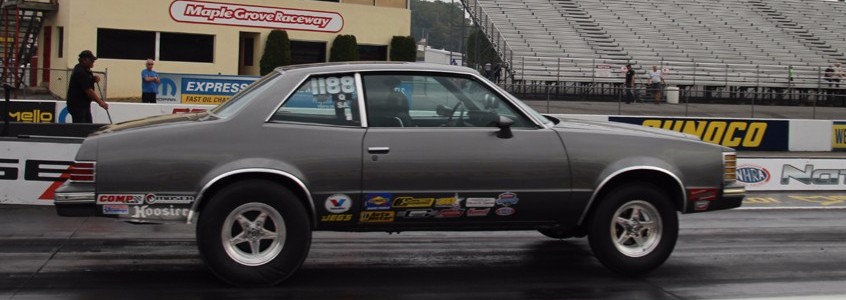

Now for the non-turbo 301 Stockers.
I assume that you will also need both the turbo crank & block.
The '79 Lemans that Billy Nees has is the only serious non-turbo 301 powered Stocker I've ever heard of.
He's shared info about it before. Don't know if he'd be willing to share any of what he's learned, here, or not.
I do remember him saying that he & Don went thru quite a few cams before they got one that worked good. And he said those 301T blocks & cranks are getting real scarce.
Any non turbo 301 drag racing info that anyone can share would be appreciated.

I assume that anyone who has seriously raced one has blown some up.
That would be a mild understatement!

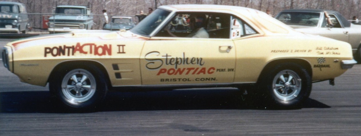

Originally Posted by gmonde View Post
yep,, that's it thanks ! any other pictures please post
Found 3 more.
Name:	Stephens '69 .jpg
ID:	53709   Click image for larger version
Name:	2 - In Line .jpg
ID:	61214   Click image for larger version
Name:	3 - Pontiaction '69 .jpg
