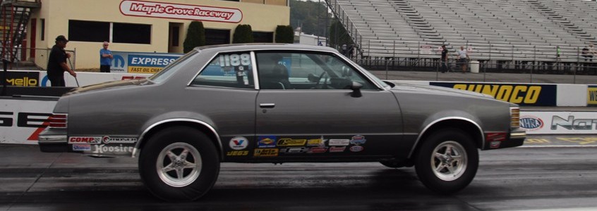

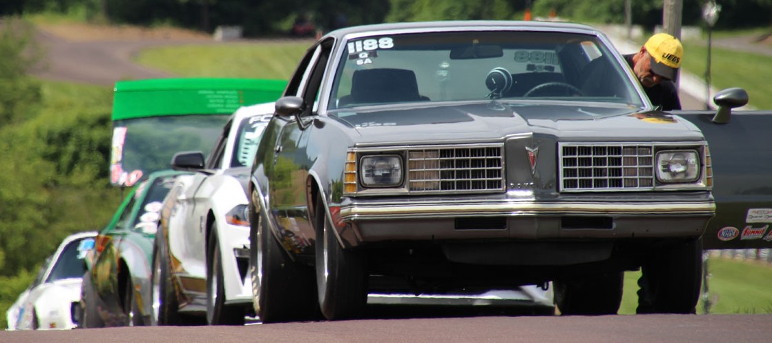

Now for the non-turbo 301 Stockers.
I assume that you will also need both the turbo crank & block.
The '79 Lemans that Billy Nees has is the only serious non-turbo 301 powered Stocker I've ever heard of.
He's shared info about it before. Don't know if he'd be willing to share any of what he's learned, here, or not.
I do remember him saying that he & Don went thru quite a few cams before they got one that worked good. And he said those 301T blocks & cranks are getting real scarce.
Any non turbo 301 drag racing info that anyone can share would be appreciated.
Name:	Billy in Line .jpg
ID:	53703   Click image for larger version
Name:	Billy Nees '79 301 .jpg

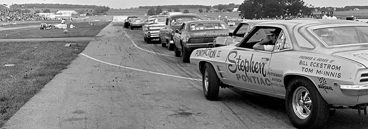

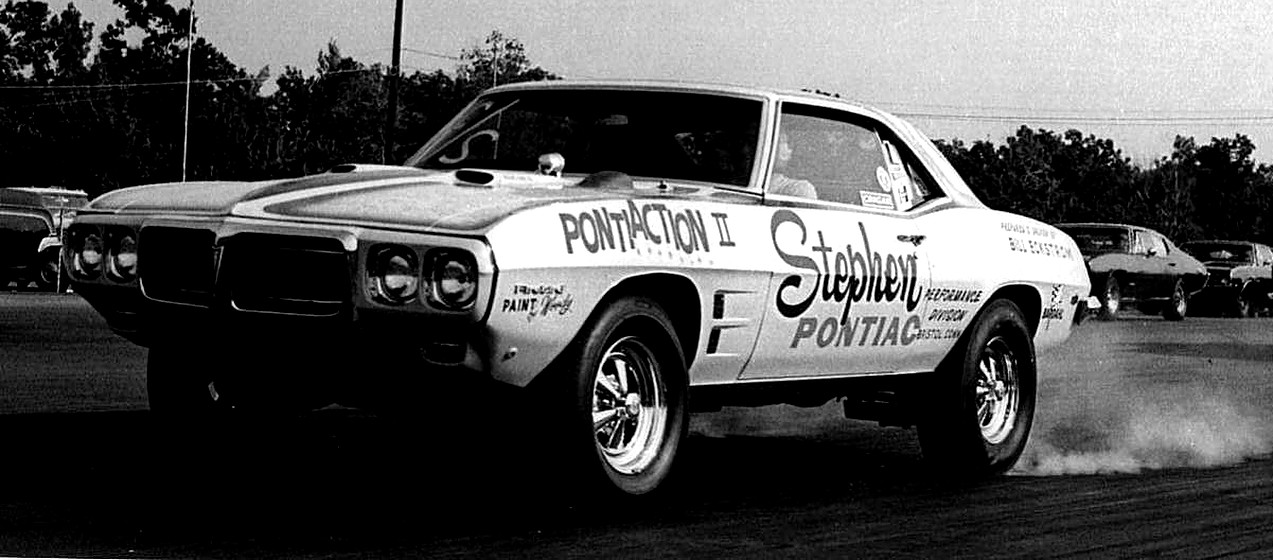

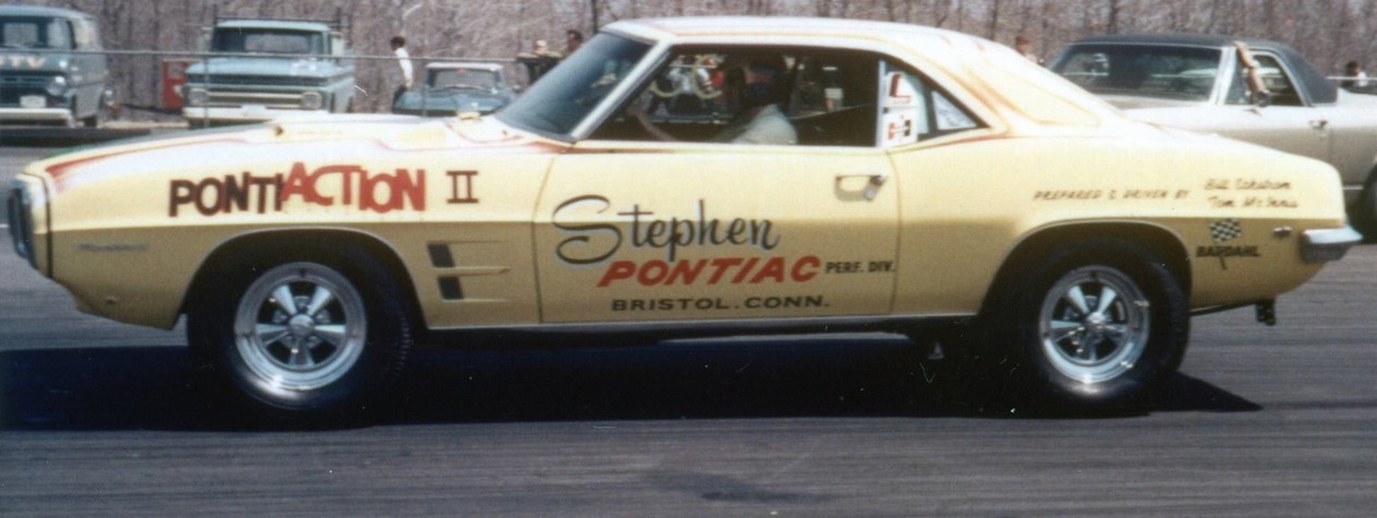

Found 3 more.
Name:	Stephens '69 .jpg
ID:	53709   Click image for larger version
Name:	2 - In Line .jpg
ID:	61214   Click image for larger version
Name:	3 - Pontiaction '69 .jpg

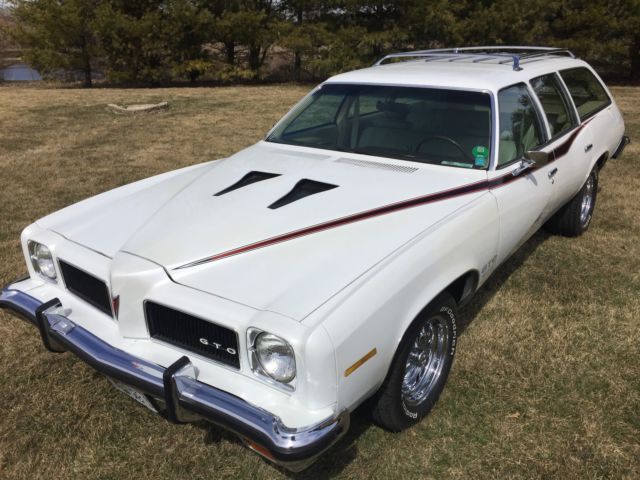

Just got some new info. As said, I've never before seen or heard of any 2-barrel Pontiac Stockers.
But, an eyewitness says that he remembers that Don Himes used to run a Pontiac Lemans wagon, with a 2-barrel. Said he don't remember it being a high qualifier, but quick enuff to compete. This was before Don had the GP.
I'll just take a guess that it was a '73 wagon with the 350 2-barrel. And, may have been the car that got NHRA to lower the hp factor. But, it could have had a 400 2-barrel.
Anybody else remember this car ?
Don't have any pics of it. But i did find a nice pic of a '73 wagon with a GTO front on it.
Old 02-03-2020, 11:34 PM   #350
Posts: 7,833
Likes: 2,928
Liked 5,146 Times in 1,964 Posts
Yes he did , but it was during the 70's pure stock era. He used to drive it around in NJ. About the same time as the Marvosh car. Before he had the white 72 wagon Stocker..
