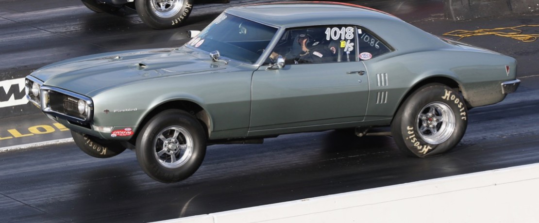

I suppose that if I had to choose a 2-speed to 3-speed conversion Pontiac to build, without doing any more research, I'd choose the '68 Firebird 350HO. The hp factor is only 305hp, & it uses a Q-jet. And Adam Strang ran some 10.80's with his 4-speed 350HO, in E/S. Not the best Pontiac combo, but far from the worst.
http://www.classracerinfo.com/Engine...8&MAKE=Pontiac
Name:	350HO @ Dutch .jpg
So what do you thing that combination would run with the auto (E/SA)?
Driver Position Car No. Class Index ET Ov/Un
11 Rick Kolber 7341 E/SA 11.90 11.018 -0.882
From Vegas today. Don't know what brand / manufacture Rick is running. But if that Pontiac combination could run 11.00 or under it would be pretty good.
