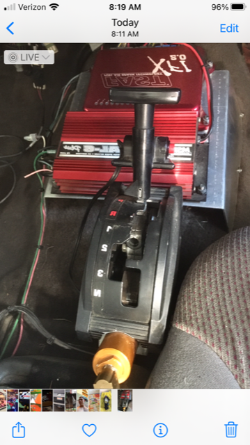

Originally Posted by cummins View Post
For ss 904 is there a air/ electric / nuclear/ mind controlled/ shifter that works with a tran brake/ clean neutral valve body
I use a ACD controller, co 2 system with my classic turbo action shifter, with clean nuetral, in the dakota, dart has newer style ta shifter same setup, both work great.
Did Paul Forte modify your TA for clean neutral, surely not just a shifter plate?
Jim Carter
2340 Super Stock
2340 SST/2340 Stock

[QUOTE=Hacksaw;699057]
Originally Posted by mnmaxwedge View Post
I looked at M&M also but they don't make a Mopar shifter.[/QU If the pattern matches, other than the trans shifter bracket what else matters?
The pattern wasn't the same with a clean neutral shifter.
mnmaxwedge is offline   Reply With Quote
Here she is
Eric Merryfield 1883 STK
Old 06-26-2024, 08:51 AM   #19
Eric Merryfield
Eric Merryfield's Avatar
Join Date: Apr 2008
Posts: 872
Liked 502 Times in 130 Posts
Default Re: Air shifter
Here she is
Its not altered, for the air shift, a spring is altered. I used to run it shifting myself, which was ideal, except for the straight 2-3 was too soft and I could too easily go from 1 to 3. If I had to do it again, I'd likely alter the shift pattern with some sheet metal like some have done to keep that from happening.
Eric

Clean neutral? That?s that little thingy that sticks up off the gate, make it taller if you feel insecure, why you pulling up the lever? That?s only used to go into reverse. I?m talking the TA shifter of course. Thousands and thousands of shifts and never 1-3 and never into reverse.
