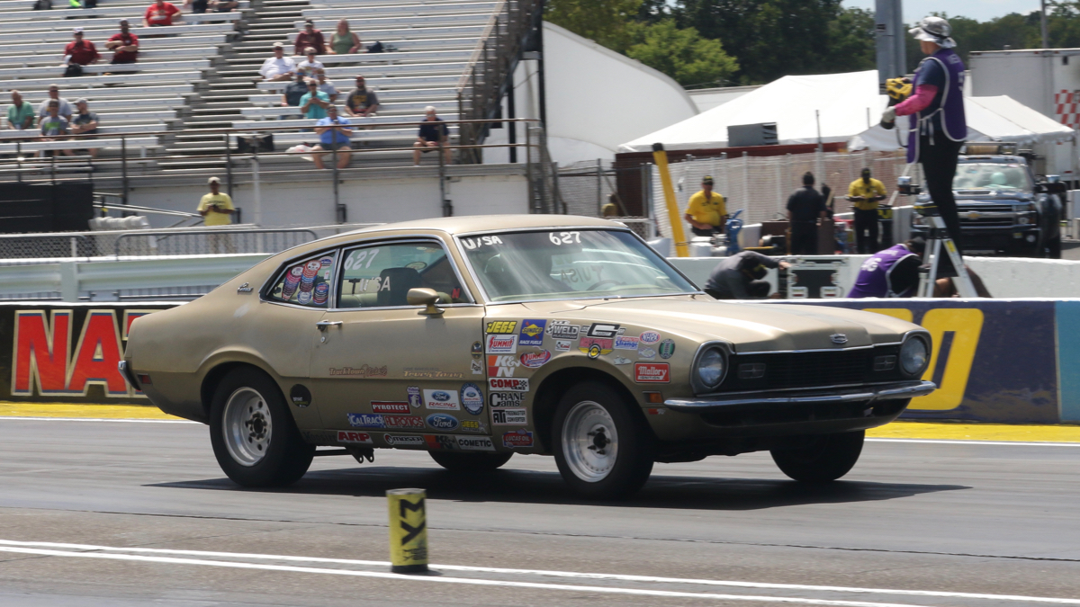

Here's our local 302 2V King. Caltracs in the top hole and what seem to be split mono springs. I don't know his rear shock package but he doesn't spend a lot of time under the car.
I run QA-1 double adjustable rear shocks and they are difficult for me to tune. Power is a 302 4V.
What is the car doing?
What do you want it to do?
