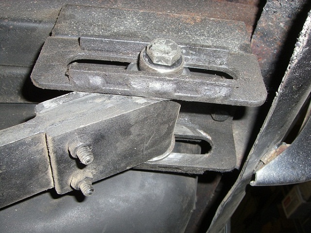

We stock and sell a lot of them.
Many go out with Cal-Trac system orders.
I love the way they work and even have them on my own car. Same AFCO's since 1998. See pics.
They do need to be lubricated 3-4 times a year.
We also stock some really cool billet aluminum shackles for racers who do not want to go through the extra work.
