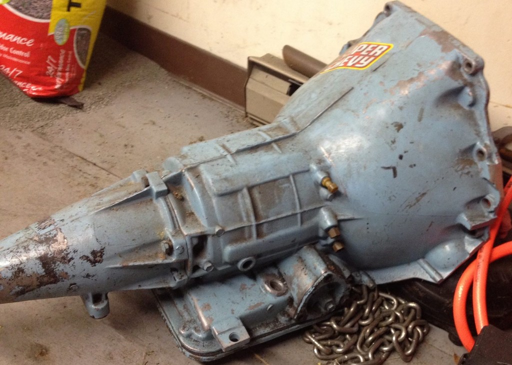

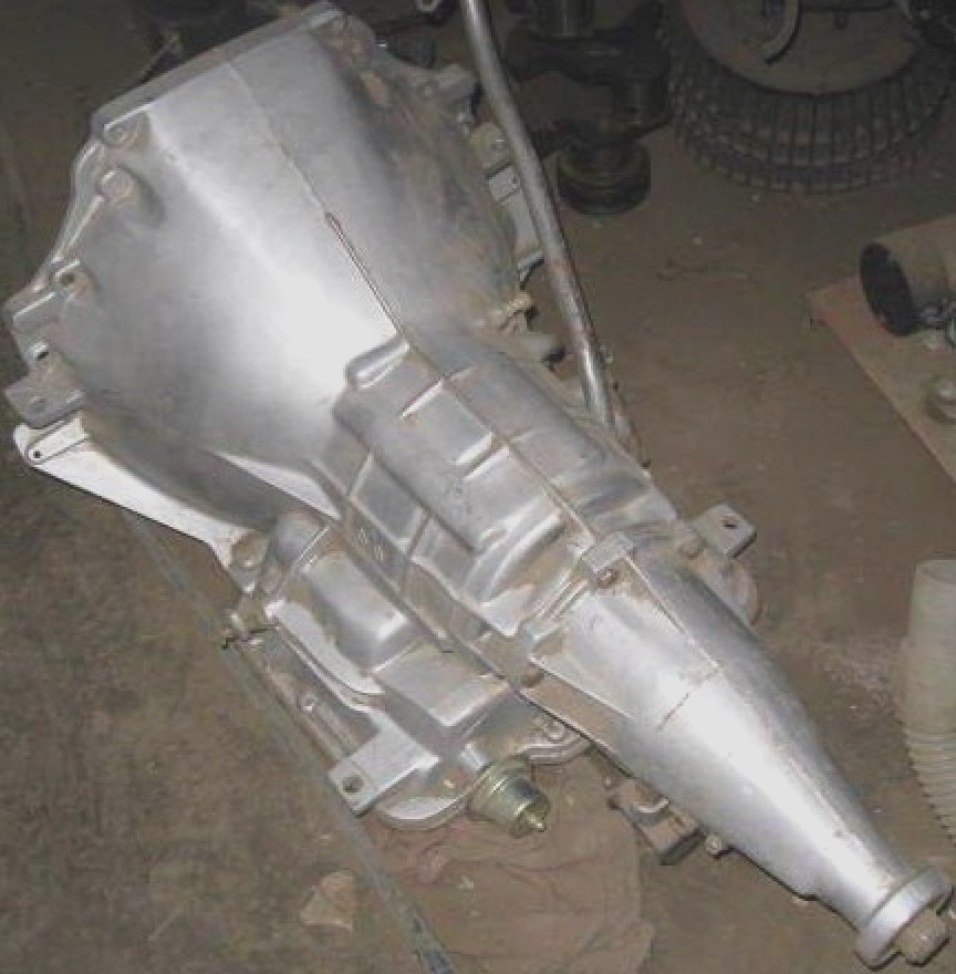

The Pontiac 2-speed auto was referred to as a "power-glide". It's my understanding that all the '64-'69 Pontiac A & F-body 2-speed autos were not Chevy Powerglides, but were what some call a "Super Turbine 300". I think these were also used in some Buicks & Olds too. IIRC, they could use a TH350/TH400 type converter.
https://en.wikipedia.org/wiki/Super_Turbine_300

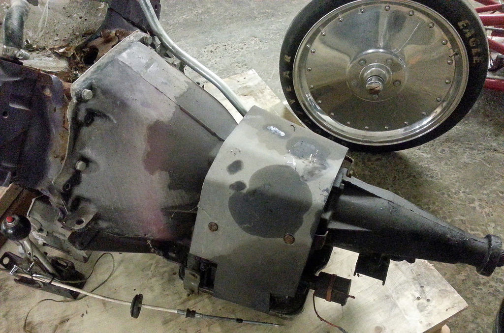

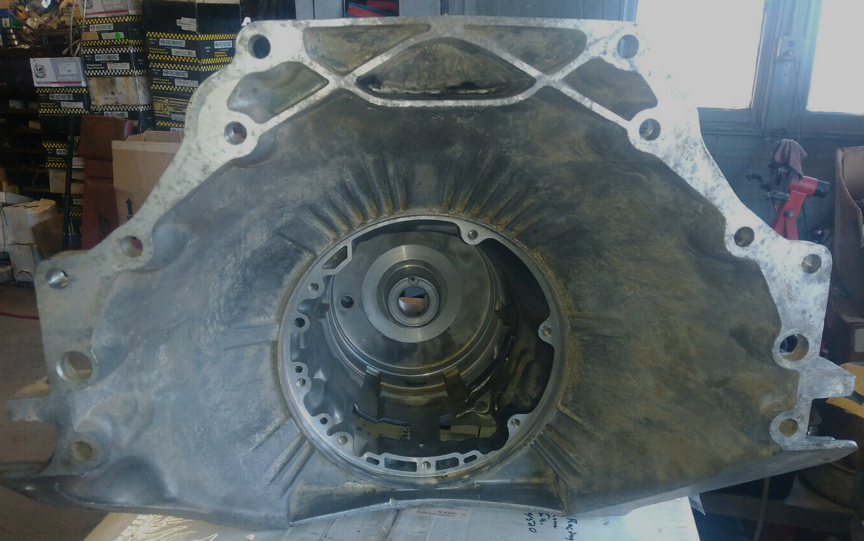

BUT, after '69, SOME Pontiacs did come with a PG trans. I think some of 'em came with a dual pattern case & some came with that same case, but only the BOP holes were drilled.
I only bought one of the dual pattern PG's. Actually bought the whole car(what was left of it) from a U-Pull-It yard. I think it was a '71 Bird. May have been a '70. When I unbolted it from the 350 engine, the bell housing part fell into several pieces. Couldn't tell it was cracked, because of all the caked on dirt. I only saw one other, which was in a Lemans. I wanna say that they only came in Pontiacs in '70 & '71, but could be wrong.
https://www.ebay.com/itm/293982744520

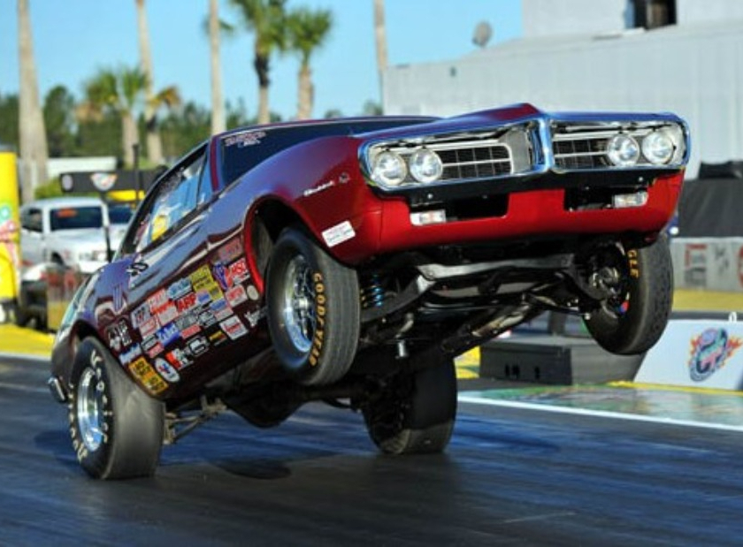

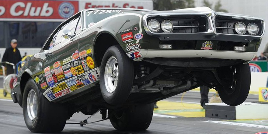

Since this thread was started nearly 10 years ago, I'll update it a bit.

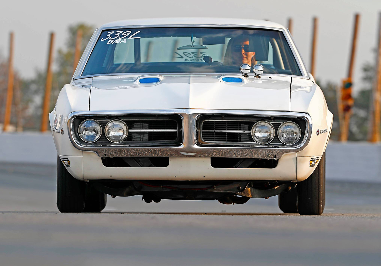

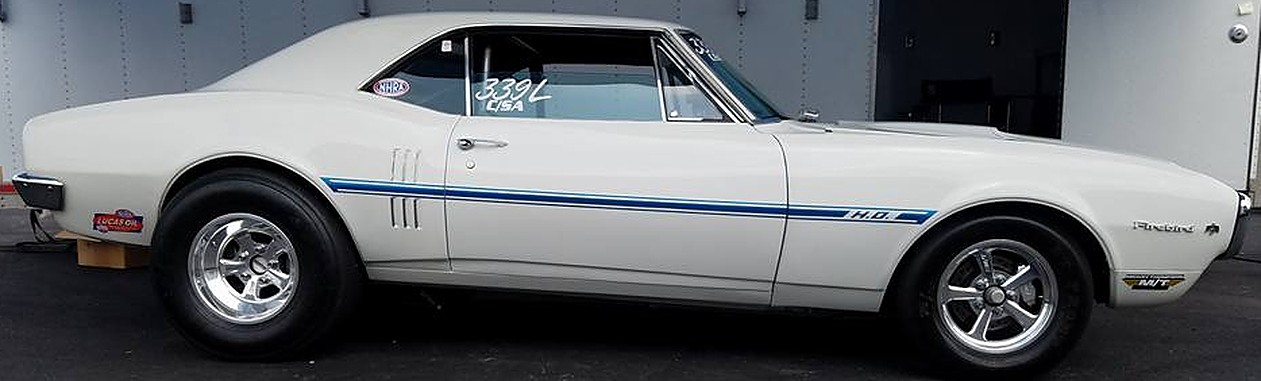

Since the thread was posted, there have been two 10 sec '67 Birds. Most all Stock/SS racers know about Randi Lyn Shipp's '67. She's won at least 7 nat events, may be 8 now. I forget.
And, most Pontiac Stock/SS racers know about Bryan Phillips's '67 Bird. It also runs 10's & has qualified near the top, at lots of races. Don't know if he's won a nat event or not. But he has won some smaller races.
Joel Larkin has the only '67 SS Bird I know of that's still active.
BTW, notice in pic #4 that Randi Lyn's '67 400 Bird has what appears to be the 326HO stripes.

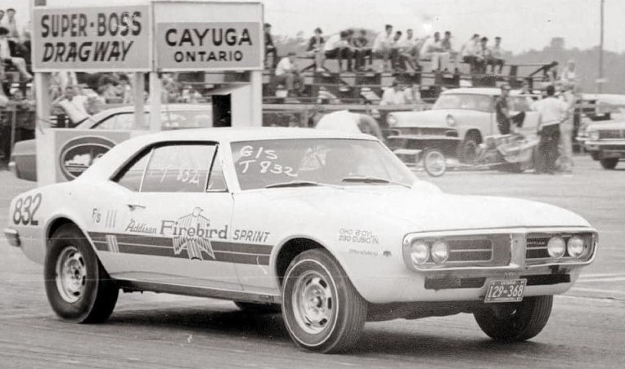

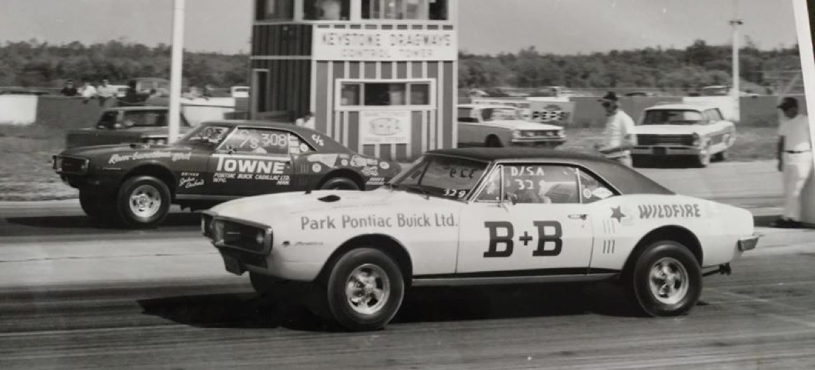

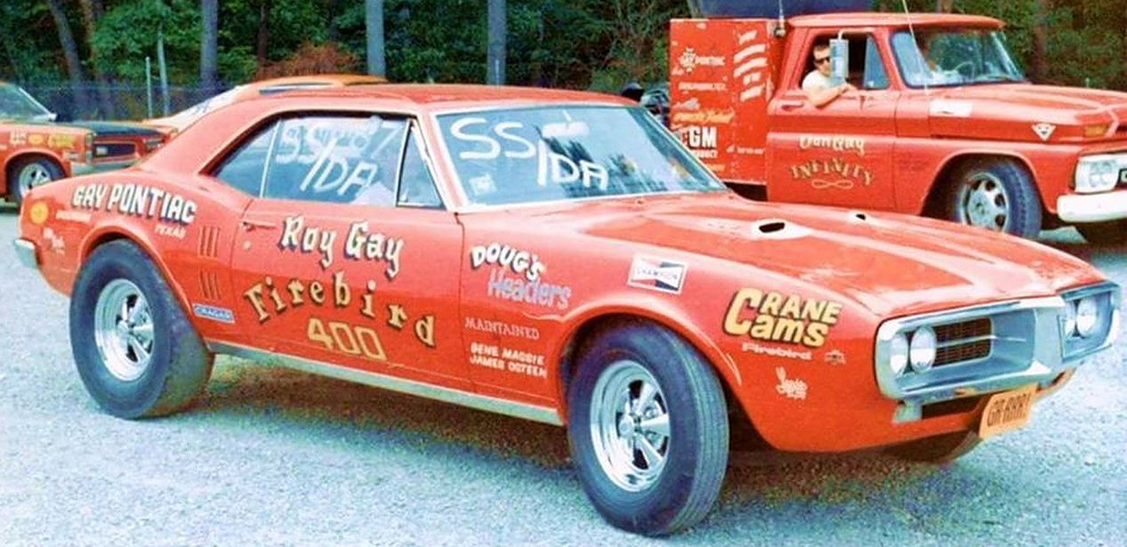

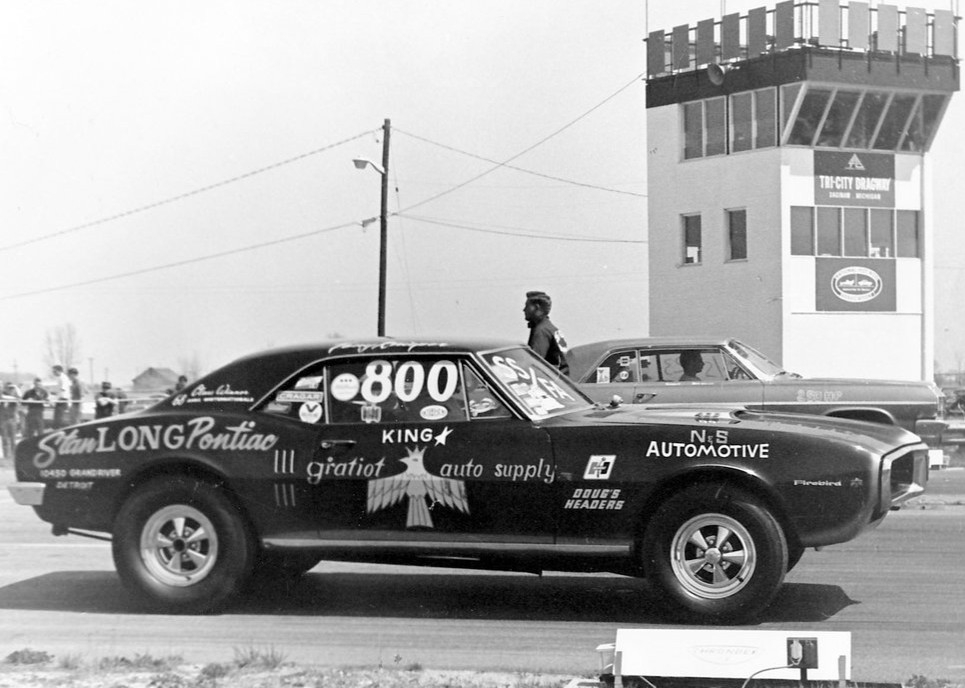

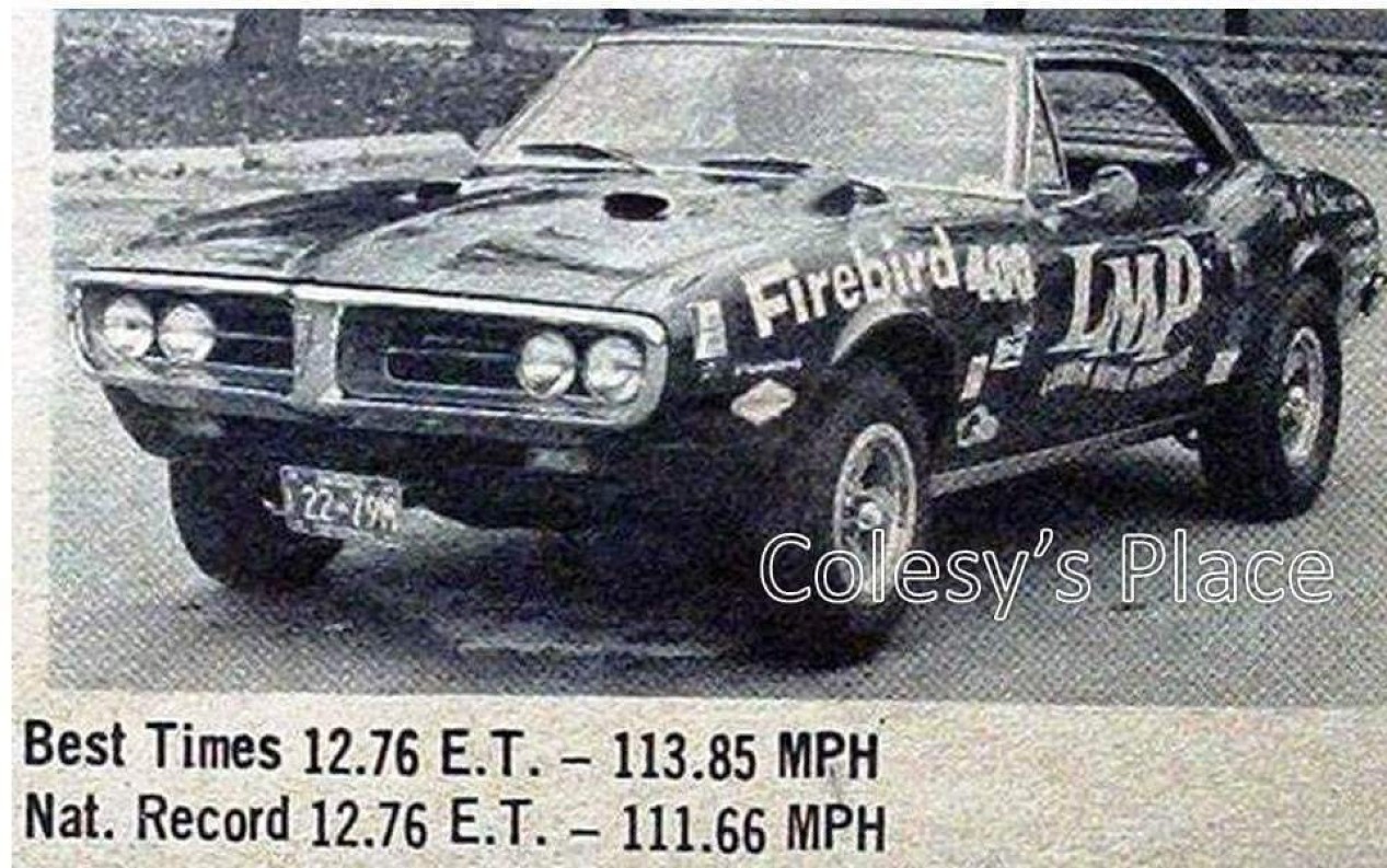

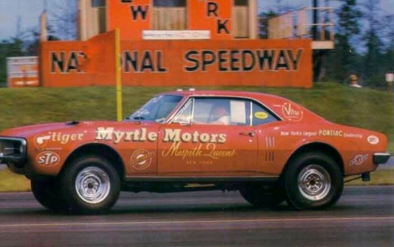

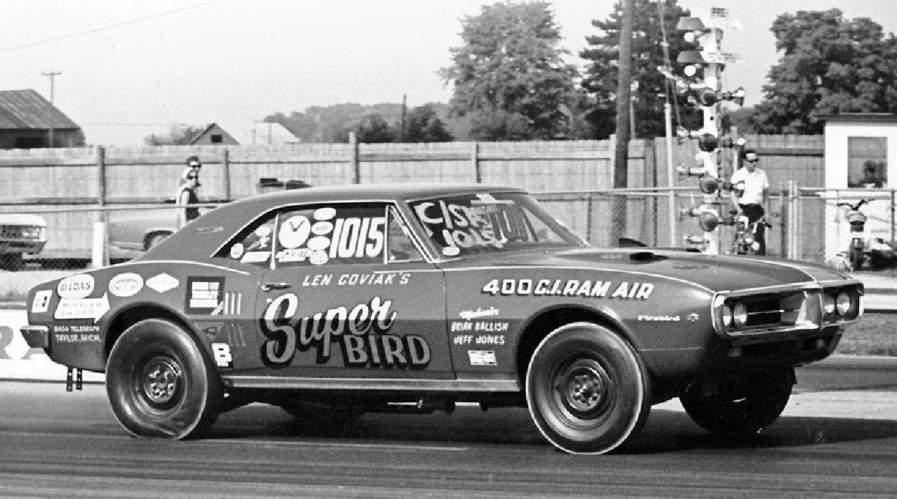

Continuing with the subject of the thread, I have pics of some '67 birds from back in the old days.
The 1st 5 are of Stockers. #5 is OHC Six powered.

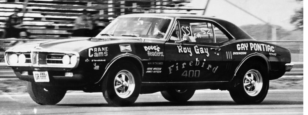

Roy Gay, of Gay Pontiac in Southeast TX, drove a '67 Bird in Super Stock. Don't have any record of times turned or race results.

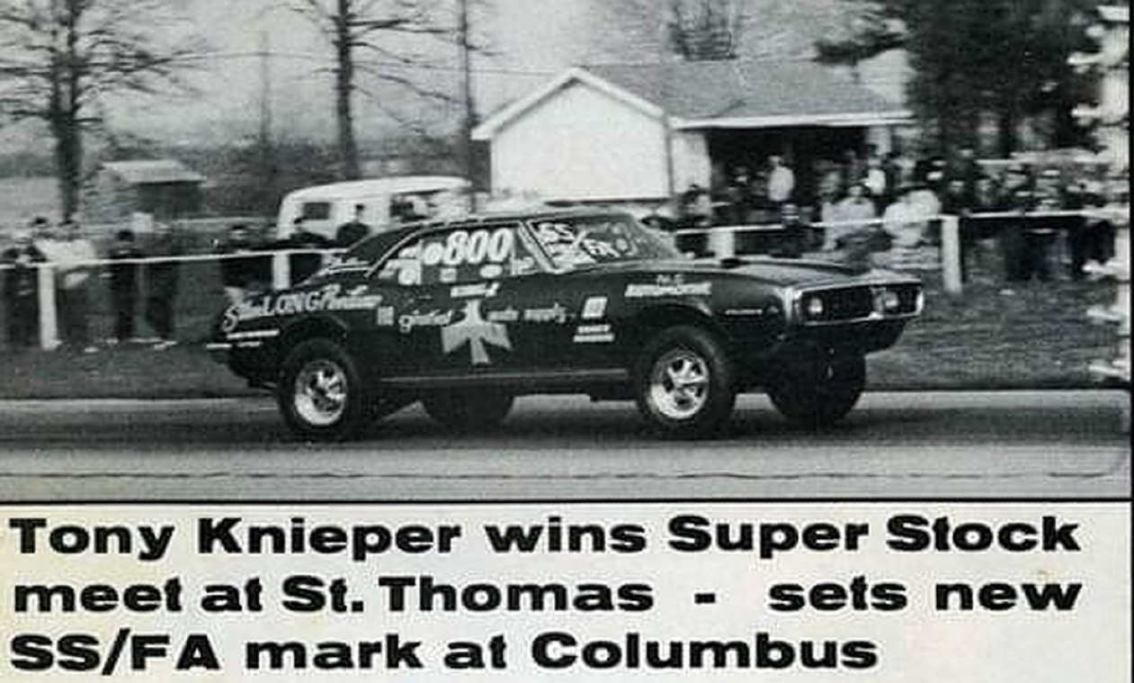

Another '67 was driven by Tony Knieper. Looks like it may have been sponsored by Gratiot Auto Supply & Stan Long Pontiac. Pic caption says the car held a nat record.

Name:	9 - Stan Long & Gratiot .jpg
