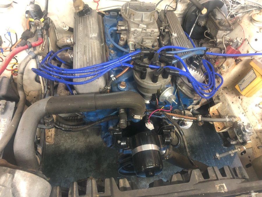

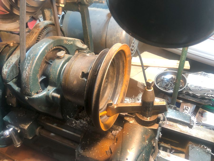

OK, I waited 7 days with parts IN THE GARAGE but I couldn't touch them because of my eye surgery...Went out to see if I could do anything small/light/not too straining.
Installed the plug wires and found one of the connectors on the cap is loose/wiggling and didn't like it so installed the original cap/rotor with the new wires. That was easy enough so...
Got the electric water pump installed and found the bottom pulley won't fit because it interferes. So, cut down the double pulley on the lathe (only use the small pulley anyway) and got that installed. Then I noticed I don't need the coolant pipe coming out of the intake so I got a plug for that and installed it.
Now I have to look where to mount the alternator since it's supposed to mount where the electric water pump is now, lol. Wife called, time for the hottub so that's it for today, tomorrow I'll get back at it.
