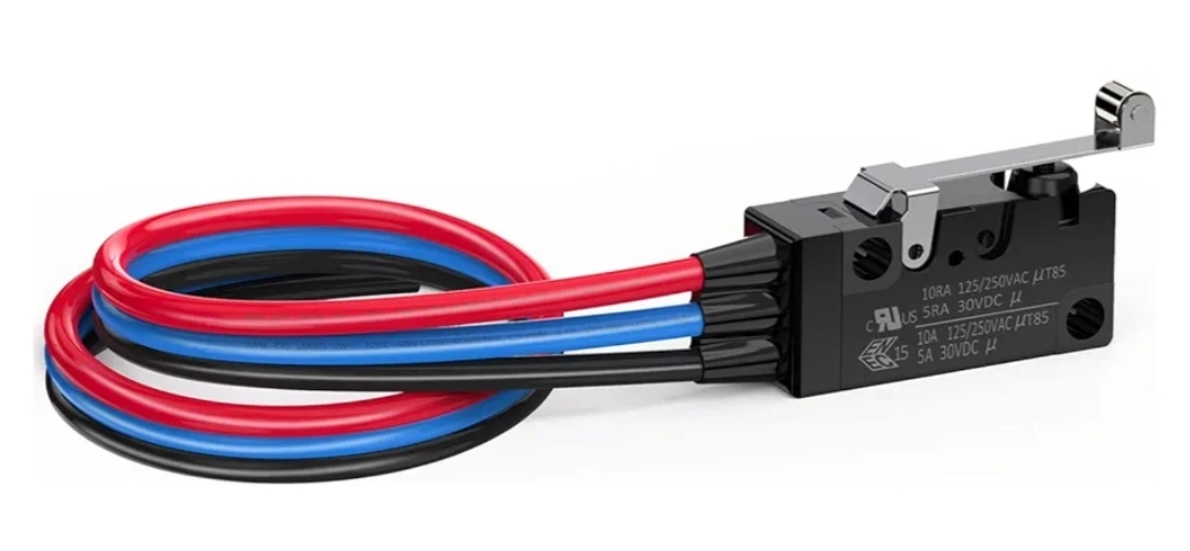

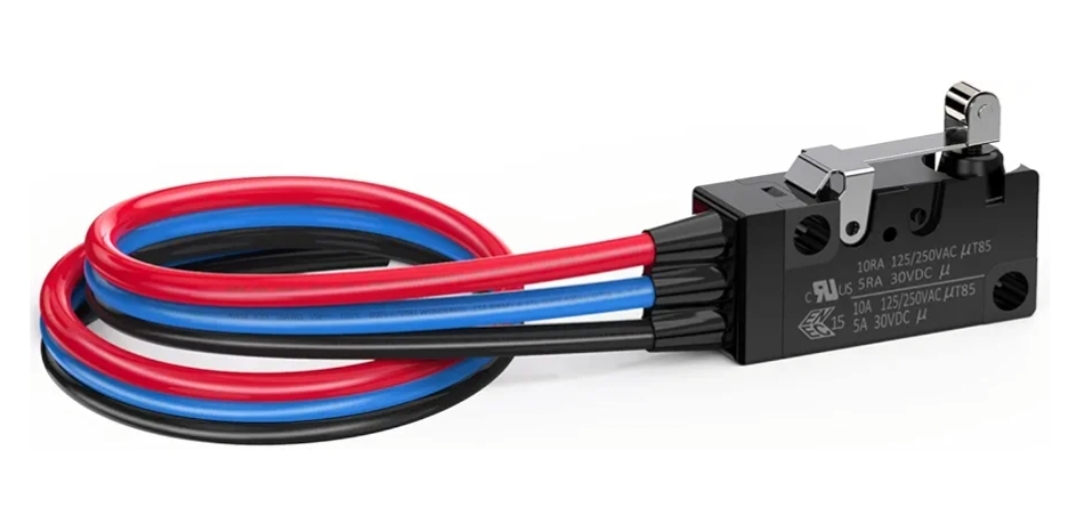

Originally Posted by Rich Biebel View Post
Anyone hook up this setup using a Turbo Action Cheetah with a reverse pattern 3 speed trans ?
I'd like to try it and making a switch to only work in low gear looks like a challenge.....
I haven't done it with a reverse pattern but I think it could be done fairly easily by mounting a momentary, lever micro switch on a bracket attached at the trans pan rail or in tandem with the shift cable bracket. Switches like these are available in short or long arm for less than $20. Should be able to activate when the shift lever arm is in low gear only.
ID:	70925   Click image for larger version

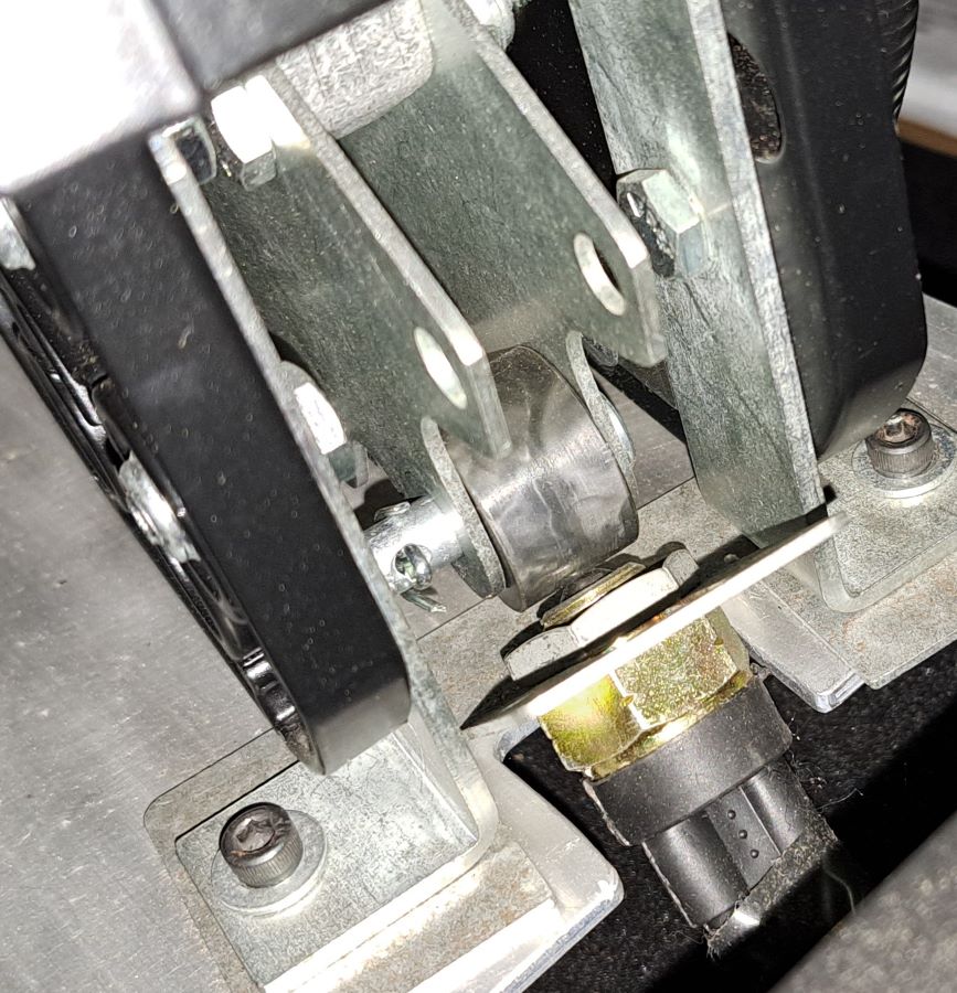

Old 07-20-2024, 04:29 PM   #10
Ben Holt
Join Date: Sep 2008
Posts: 142
Liked 112 Times in 40 Posts
Default Re: Brake Pressure Switch for launch control ???
Just curious how much brake pressure do you use at the starting line? I have seen a lot of data and have never seen brake pressure over 4-500 psi (on 160 mph plus cars). I would think anymore than that would lock em up bad at the stripe.....
