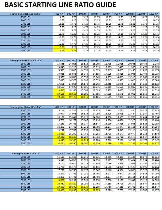

here's a more detailed chart borrowed from Cale Aransons Black Magic clutch website ..........lots of useful information there.
http://www.blackmagicclutches.com/index.html
