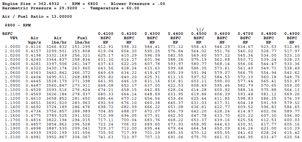

Default Re: How much CFM does it take
As stated above a number of factors come into play. What it really comes down to is how efficiently you are able to use the fuel.
Stan
