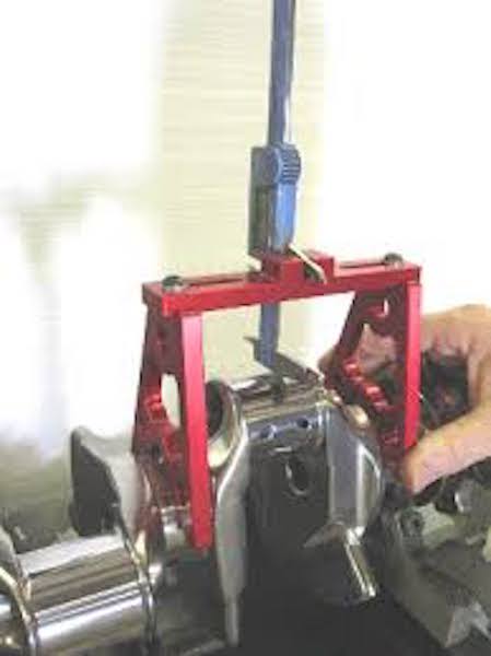

when you are grinding a stocker crank you better have a stroke gauge.. crank grinders are set for stroke but it doesn't always come out exactly what it is set to .... we go +.013 and if you miss by a couple thou on the stroke wont check legal... I check stroke as I go and some times have to adjust +/- a few thou on stroke...

Every crankshaft grind starts with a straiten and then this.
Name:	stroke checker.jpg
