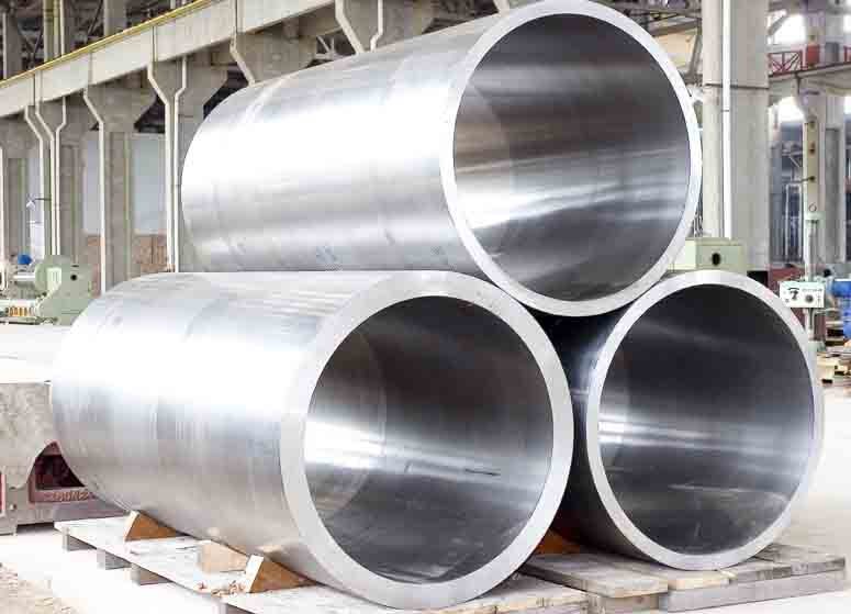

Here you go Mike LOL

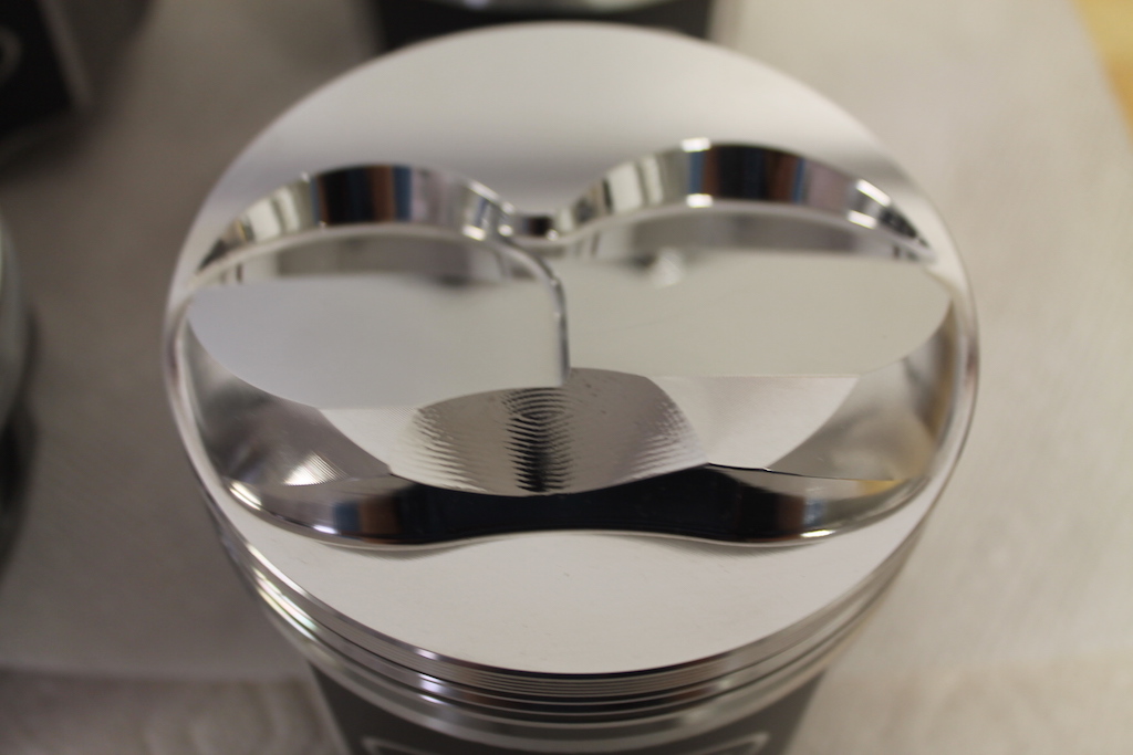

I got the pistons last week, Icon .040 -12.7 CC dome, they came in at 712 grams with pin after some work.
