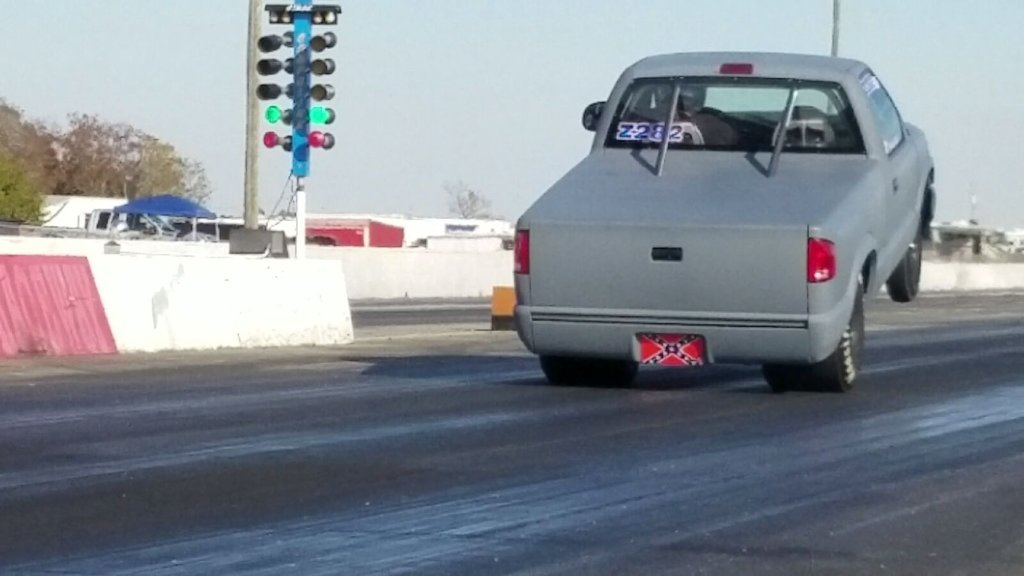

Actually Joe we might, I have made more than a few passes at Atlanta Dragway a couple of decades ago.
As I recall your car is more of an "old school" setup. A lot of folks used to basically lock the front end down and didn't pay attention to the quality of the (limited) front end travel.
The front end needs to be (very) free to travel, the springs need to contain a lot of stored energy to allow the weight transfer to take place, and the shocks need to control the rate of reaction. Then you can control the height of the wheelstand (if need be) with front end travel.
I'll enclose a picture. This truck was built as a super stocker, with ladder bars and coil overs, they upgraded the front end components and got this result.
I haven't seen it on scales, but it's pretty nose heavy. No big chunks of lead in the back of the truck.

Originally Posted by Tom Broome View Post
Thanks for the compliment Mark.
