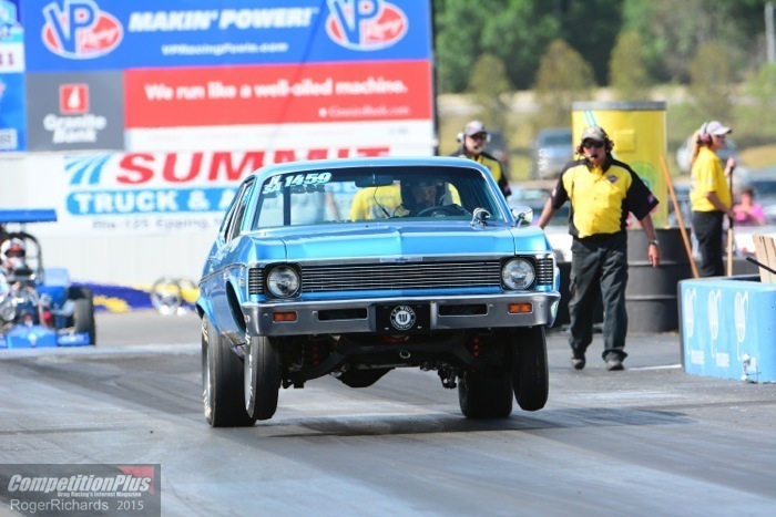

Todd: Good luck my son has a Nova stocker and if we can be of any help feel free to reach out - Bob

Thank you Bob, I just may do that. And a 68-72 Nova may be our stepping stone in the future. Oh and that's a beautiful car he has there!
