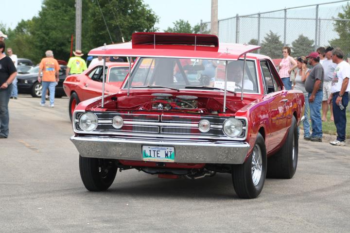

This is a photo that was posted by Dan Williams on facebook taken by Stewart Pomeroy at Fred Engelharts Hemi Reunion 2006.
