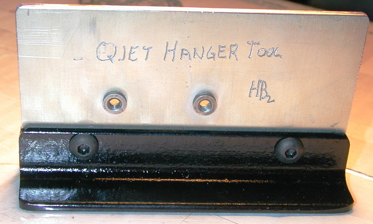

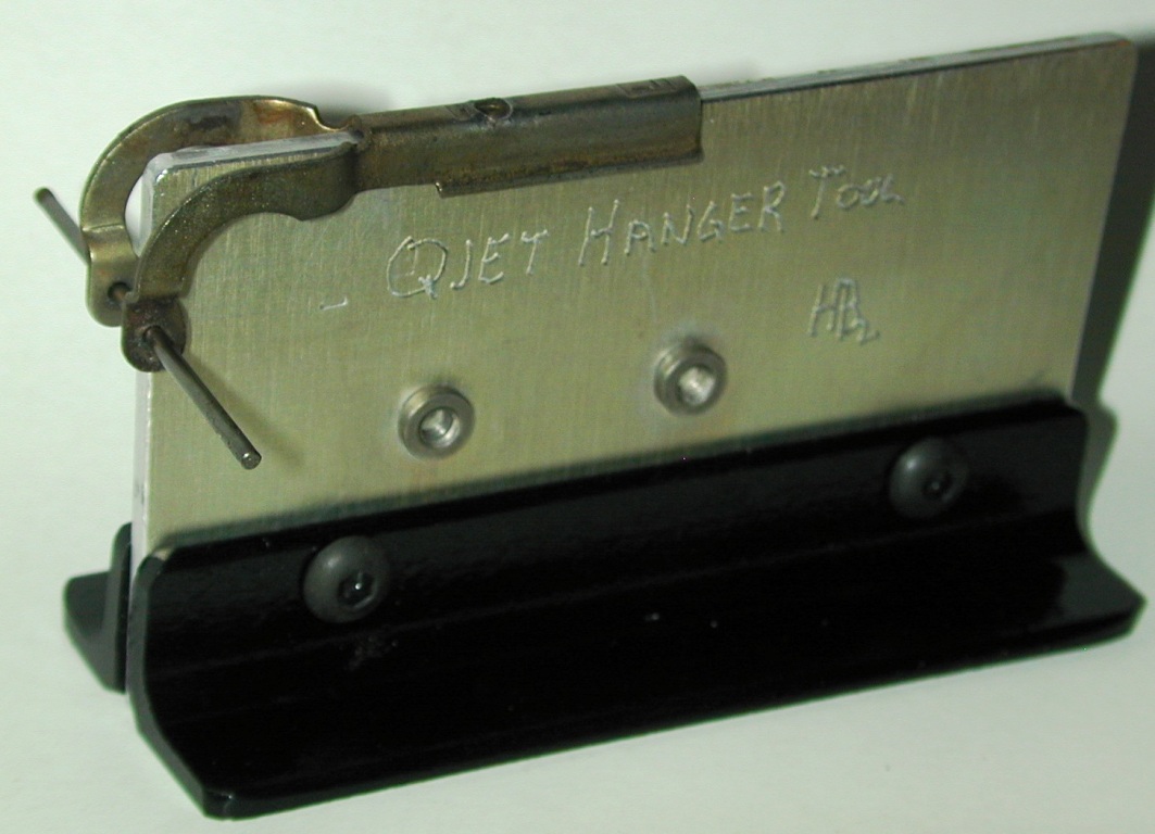

Forum Folks that might be interested in an easy solution to measuring QJet Hangers:
Easy to build out of scrap stuff. Center piece is 1/8" aluminum but could be steel or whatever. Bottom is built from couple of pieces of 3/4" x 1/8" angle iron so it is easy to keep upright when used. Will include a few photos for reference. Most folks do not need this kind of accuracy but it is easy to use anyway. Soon as I figure how to resize the pics that is.
Measure from the top surface to the pin (0.067" diam) with dial caliper.
Regards to All,
Dissident
