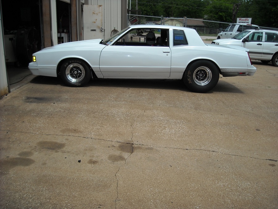

some more information to consider;
*this Monte Carlo is 3155 pounds with driver
*408 CI SBC
*powerglide
*footbrake
*31 x 13 radial tire
*The ladder bar is 32" center of rear axle to center of the front rod end. It is 2 degrees down in relation to the ground in this photo.The right ladder bar has one-half flat pre-load
It also has an anti-roll bar that is set neutral.
This car is excellent, consistent, and predictable. It runs 6.0's 1/8 mile
