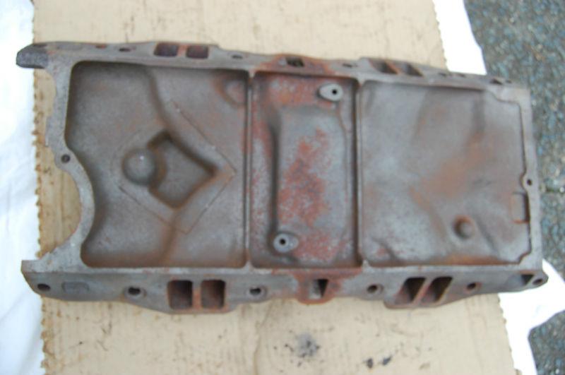

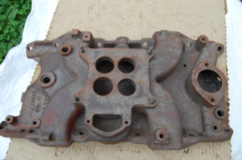

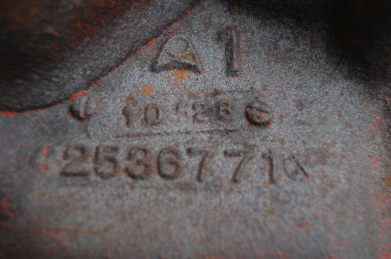

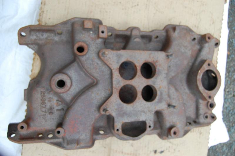

D-Darts had factory modified (intake openings bored out to accept Holley) standard 273 intakes. AND adapter plates.
The D-Dart intake manifold, P/N 2536771, is identical to the 318 marine engine intake.
It's a single plane cast iron intake with an adapter for the Holley carburetor.
771 is also listed as 66 California.
