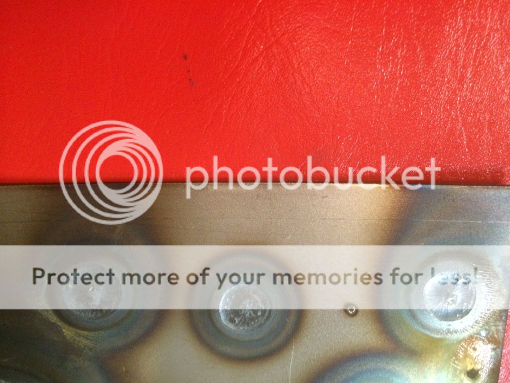

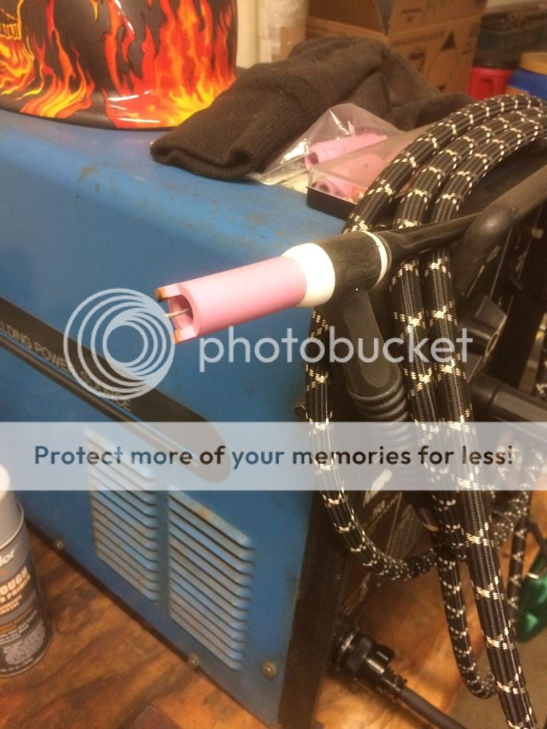

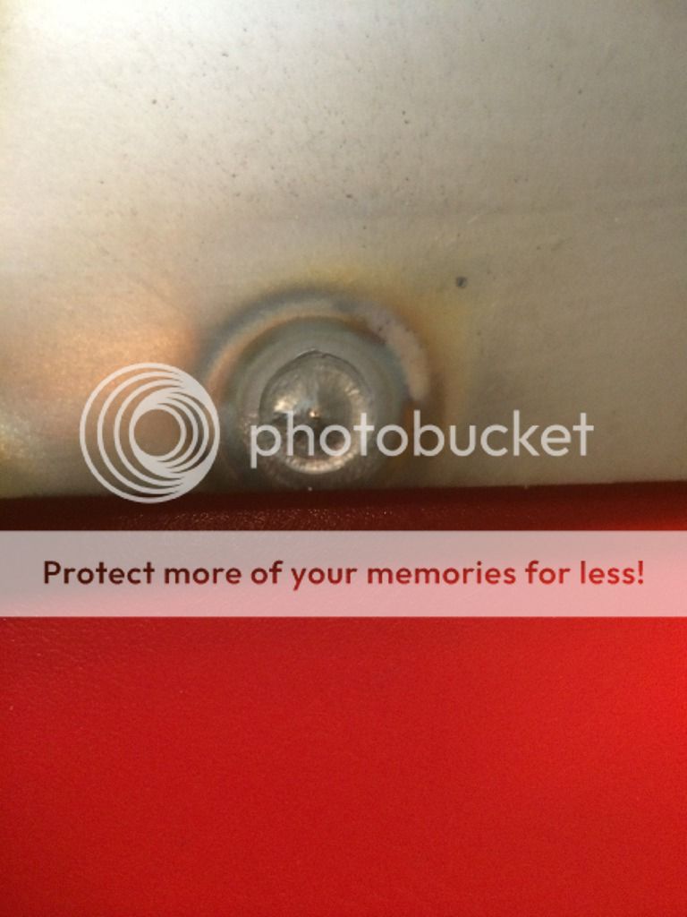

I got these spot weld cups for the tig to create that "factory" look they actually work pretty darn good. I will still stitch weld all the overlapped panels with the tig though just to be safe.

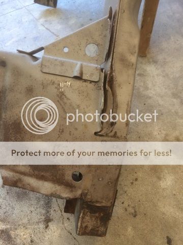

Torque box reconstruction

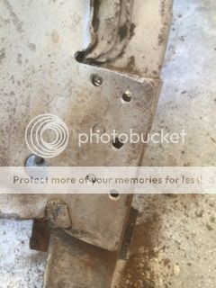

The next series of photos will be of interest to some and not so much to others. This part of the project has been on the sidelines for awhile while I pondered the thought of eliminating the torque boxes alltogether, as bar 6A and 6B of the 25.5C floor would take its place and bars 2A would intersect the front factory frame rails.
But......since this is a "stock" eliminator project I came to the conclusion that
1) it would create to much controversy as not "stock" (even though I have approval in writing) and
2) I just was not satisfied with all the front end sheetmetal and the engine "hanging" from just the firewall becuase I have no motor plate or mid plate to work with
Bill Diehl B200 C/D STK

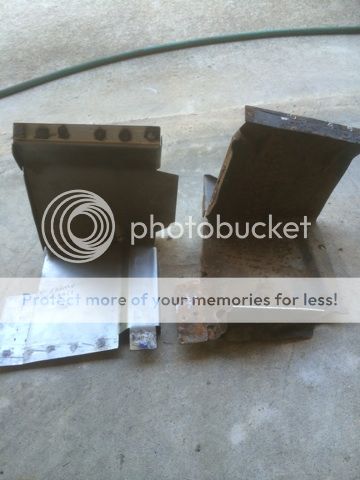

Default Re: Boss Mustang stocker

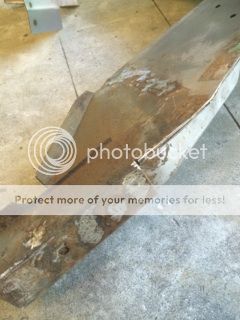

Previous owner must have thought this was a 4x4 because the damage to the undercarrige was substantial...previous photos show I have a new engine crossmember and strut rod crossmember also.

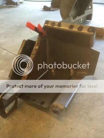

Posts: 311
Liked 9 Times in 8 Posts
The engine, driveline and shock towers in these years 71-73 are offset 3/4" from centerline so....

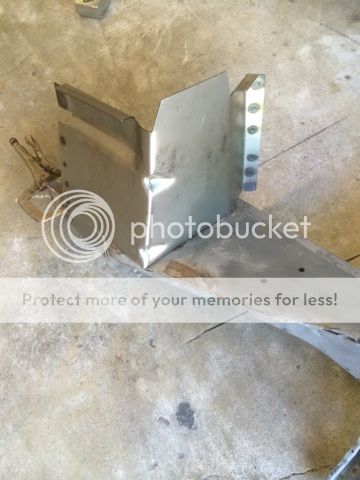

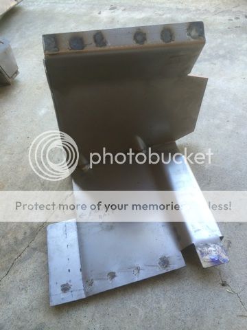

Posts: 311
Now I have to do the drivers side and then get it on the jig to put it all together.
you can see how the 25.5C "frame" will tie it all together
