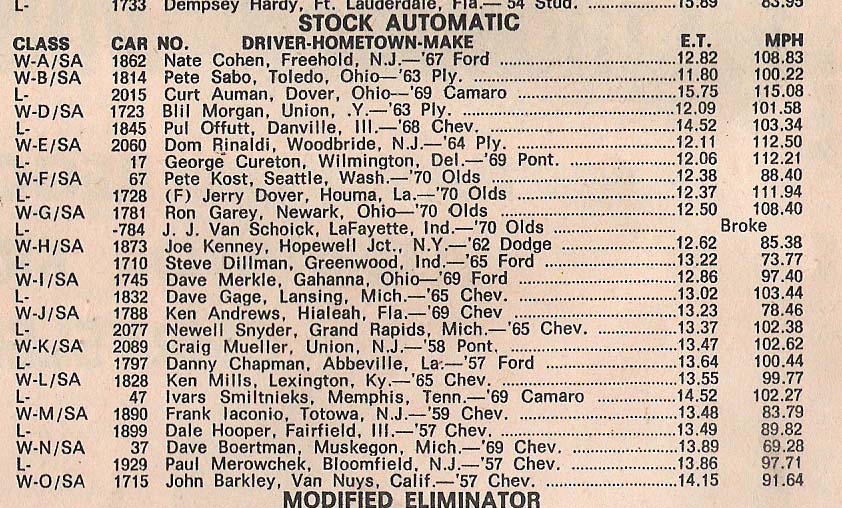

Have a lot ,but can't resize them to fit.
Name:	1970 INDY STK auto Class winners redone.jpg
I was disappointed that they left off the r/u of O/SA because it was yours truly.
Dick Butler 14.266 94.4 MPH.
Still think that running without water in the motor(therefore no resistance to water pump) helped the winner...
Dick,
If you can provide details about your combo it would help my historical effort. Year/make/model/engine/trans/rear, anything else special.
Also if you recall any of the other cars on that sheet - some of them are obviously "brake light" runs so I don't learn much from Gonkulating them. EG I think these were "Brake Light" runs:
A/SA Cohen 427/425?
D/SA Morgan 426/415 wagon?
F/SA Kost w30
H/SA kenney
H/SA Dillman, something broke?
J/SA Andrews
M/SA Iaconio
N/SA Boertman Biscayne LM1
As you can see I am scrounging to determine the model/engine of these cars, but the Brake Light runs don't really matter since I am trying to match the MPH.
As you know the sheet just says "69 Chev" etc, no model, no engine/hp so it's often hard to figure out.

Nate Cohen 427/425 was a 67 Fairlane I believe. Joe Kenny was a 62 Mopar wagon 383/343. Frank Iaconio was a 57 Chevy 2dr sedan run with a 250 HP FI engine with a P/G.Dave Boertman was a 69 full size Chevy with a 350/255, Bill Morgan was a max wedge Plymouth wagon....as in Tritak and Morgan....War Wagon
