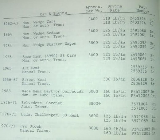

This is from the old DC "Bible"...
ID:	32402   Click image for larger version

Dang those Street Hemi springs are stiff

That would almost seem right. My '66 Hemi Coronet Sedan had factory leafs with a few extra leaves added in the middle. It didn't even budge when you pushed down on the car. They're in the attic now, haha.
