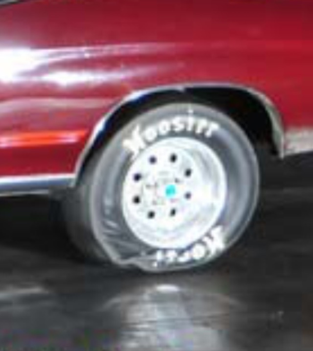

I recently changed to tubeless slicks,Hoosier 29 x 9 (bias ply).The car is an automatic weighing 3300 pounds.I am still running 12.75 pounds of air.But after looking at this picture I think I need to raise the pressure.Any suggestions of where the pressure should be?

I've heard pressures from 14 to 25+ lbs from 9" tire racers. Lot's of variables, but most seem to be in the high teen to low 20 range. I have Hoosier 9"X 30" Lightweight Radial Slicks at 21 lbs on a 10" rim, car weighing 3,540 and footbraking. Wider rims allow more pressure and radials seem to like a little more than bias ply. I fine-tuned it by watching if contact is being made all the way across the tread (may need less if not) or if rubber is being laid over the side (may need more).

They are 15 x 10 rims. The car is working great ,but I'm concerned about how safe it is.Thinking of going up 1/2 to 3/4 of a pound and see what happens.

What does the car usually 60' like? Definitely more pressure, the tire looks like it's trying to roll over itself.
I would up the pressure a bit, work towards 13-14lbs., and maybe make a shock adjustment if needed also.

Usually low to mid 1.60's. I will have to up the pressure and mess with the rear shocks.I see a day of testing in my future. Thanks
