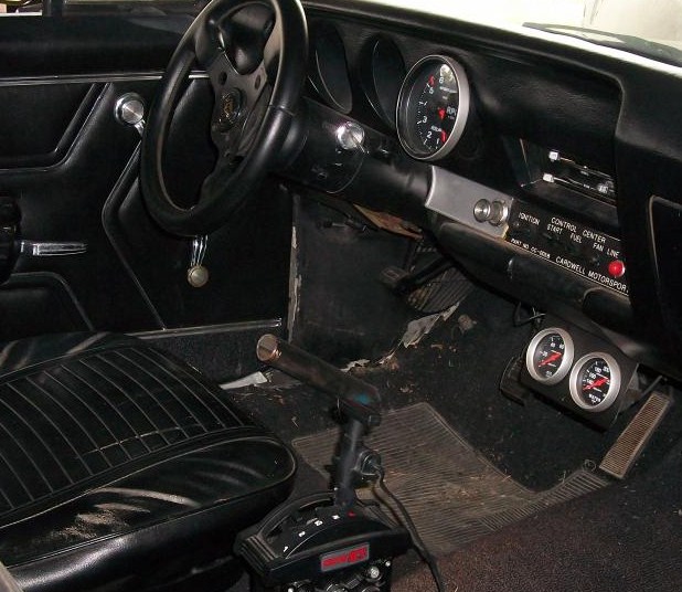

I remember the name McIntosh, but right now can't quite remember the car they ran back then. I do know of the Cardwell family in Ruston. In fact I bought a set of used 9" slicks from them for one of my Stockers. Also, they built the '69 Tempest Stocker which I bought back in '09. I was surprised to hear that they built a Pontiac, since they had always run Chevy, as far as I knew.
The guy I bought the car from said they were going to try to race it, but could only get it down to within a tenth of the index, so they decided there was not enuff potential there to flog it any further, and sold it to him. Their choice of engines showed that they were not real Pontiac guys. I think they had always run mostly the 350 Chevy. So, they tried a 350HO Pontiac. But what they did not know is that there are lots of Pontiac engines with more potential because of a more favorable hp factor. The engine made 434hp on the dyno, but was not quite enuff for the combo. But hey, it sounded good and would have made a good bracket car.
That was just a little side trip there, for entertainment purposes.
Now, as for Wesley, I'm not ready for his level of scrutiny yet. When I get down to working out minor details, I may contact him.
The switchboard in the Tempest had Cardwell Motorsports printed on it.
