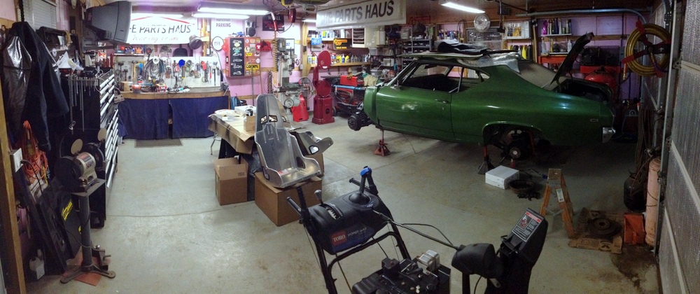

Where all the works go down. Everything we need in here, except a bank vault, to go racing.

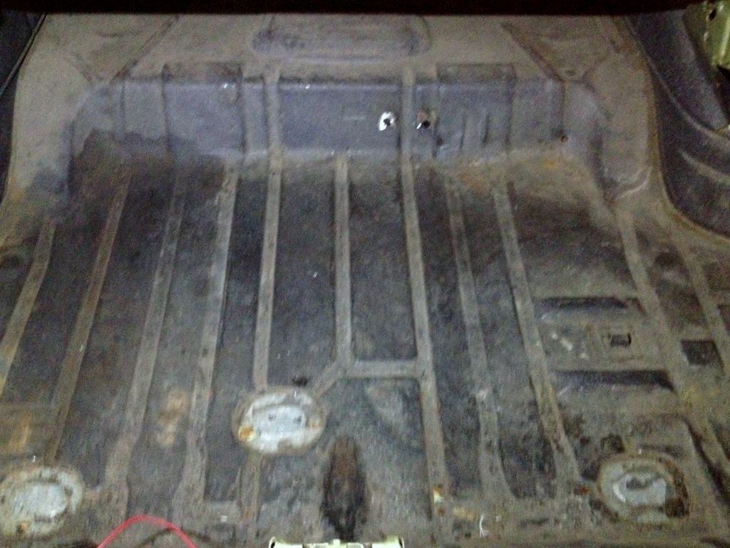

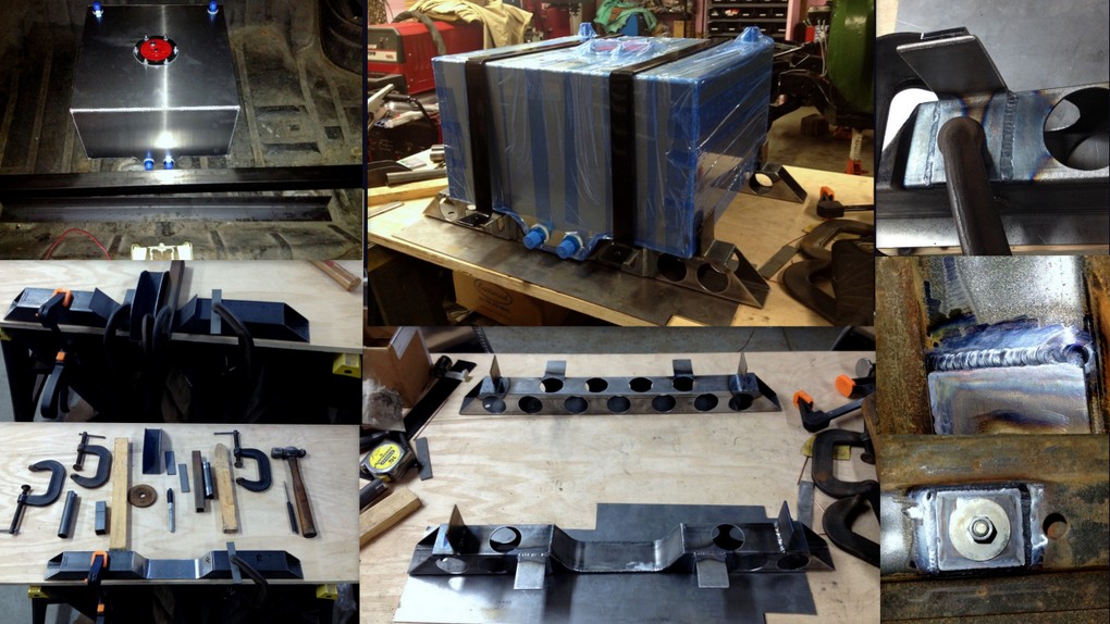

Fuel Cell mounts all done. JAZ 10 gal cell, 2" sq mild steel, 2" mild steel angle and some really poorly made, not bent square Jegs (hence why they were cheap) over the top fuel cell straps. Nothing too crazy, just tried to make it simple and safe. I ran 3/8" bolts through the 2" tubing and through the fore-aft stock fuel tank crossmembers. I added some .125" thick plate 4130 welded on the under the side at all 4 through bolt locations just to be safe. For final assy the cell will be sitting on 1/8" thick rubber to avoid and abrasion/ vibration issues. I am happy with how it came out. Still pressing forward on this project.

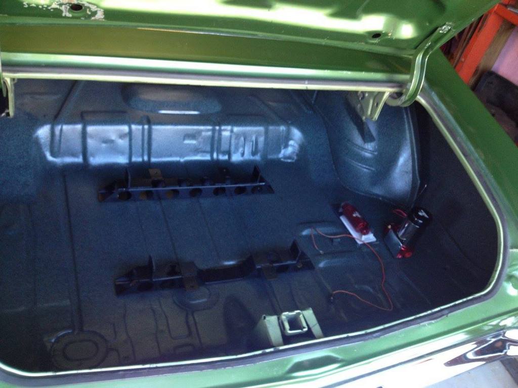

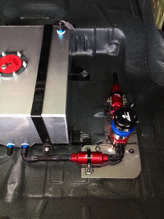

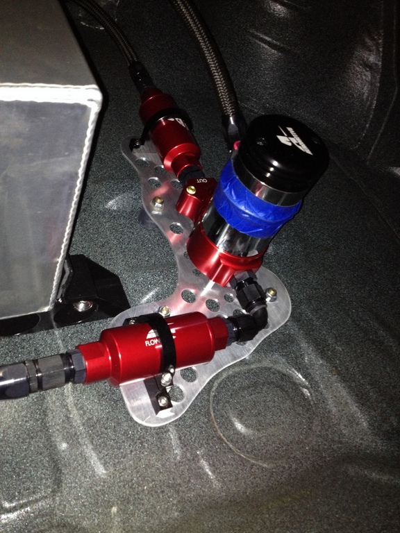

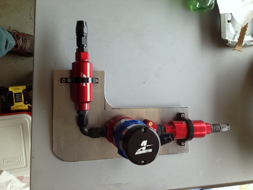

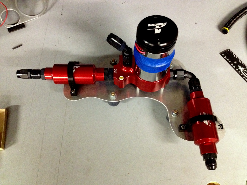

Fuel cell, fuel delivery system & trunk work. Welded up about 15 holes in the trunk. Fully wired the rear of the car and it is now done. Used Eastwood trunk paint to match the turquoise & black splatter it came with. This stuff is water based and needs a clear coat top coat to be durable. Just don't let fluid of any type sit on it, and it will look pretty for a while.
ID:	31877   Click image for larger version
ID:	31878   Click image for larger version
ID:	31880   Click image for larger version
ID:	31881   Click image for larger version
ID:	31883   Click image for larger version

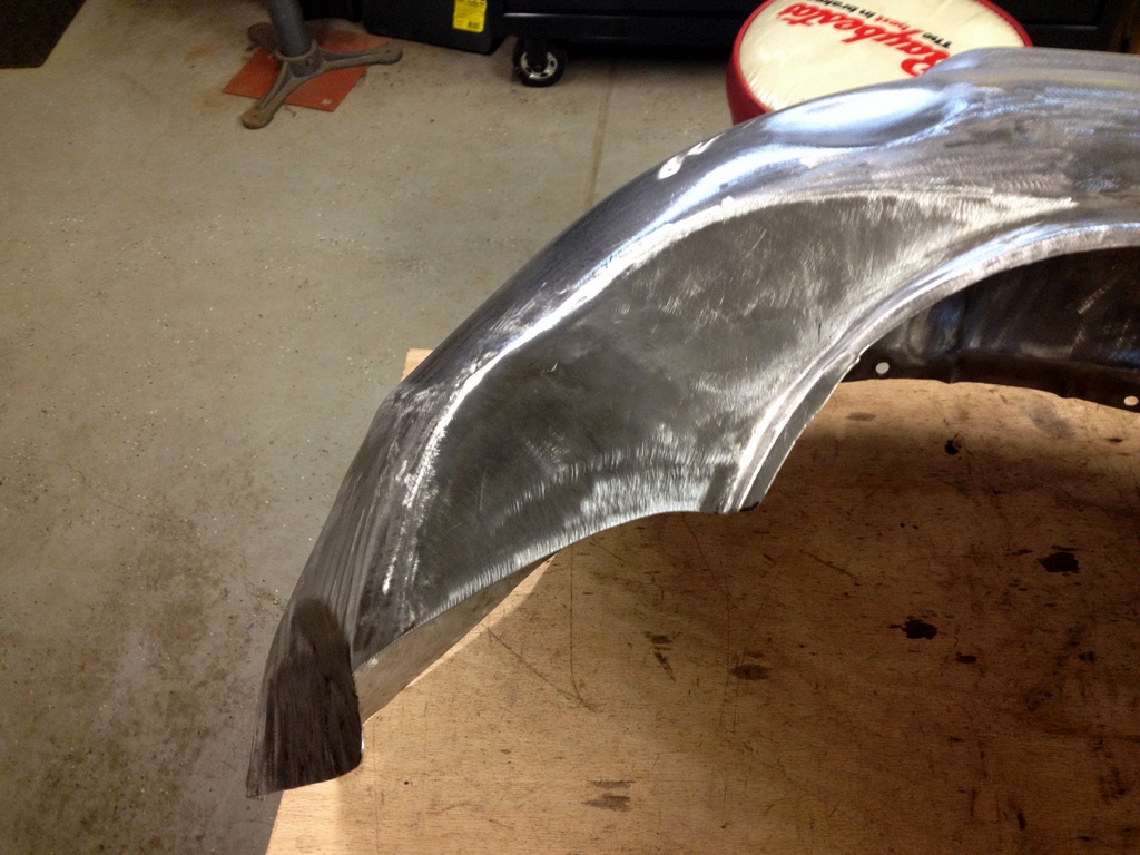

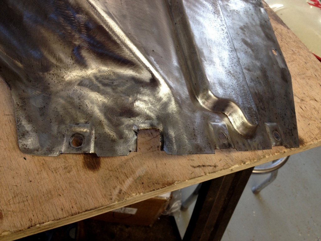

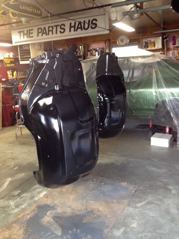

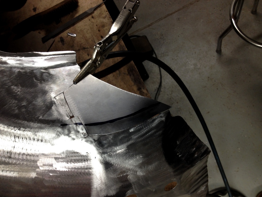

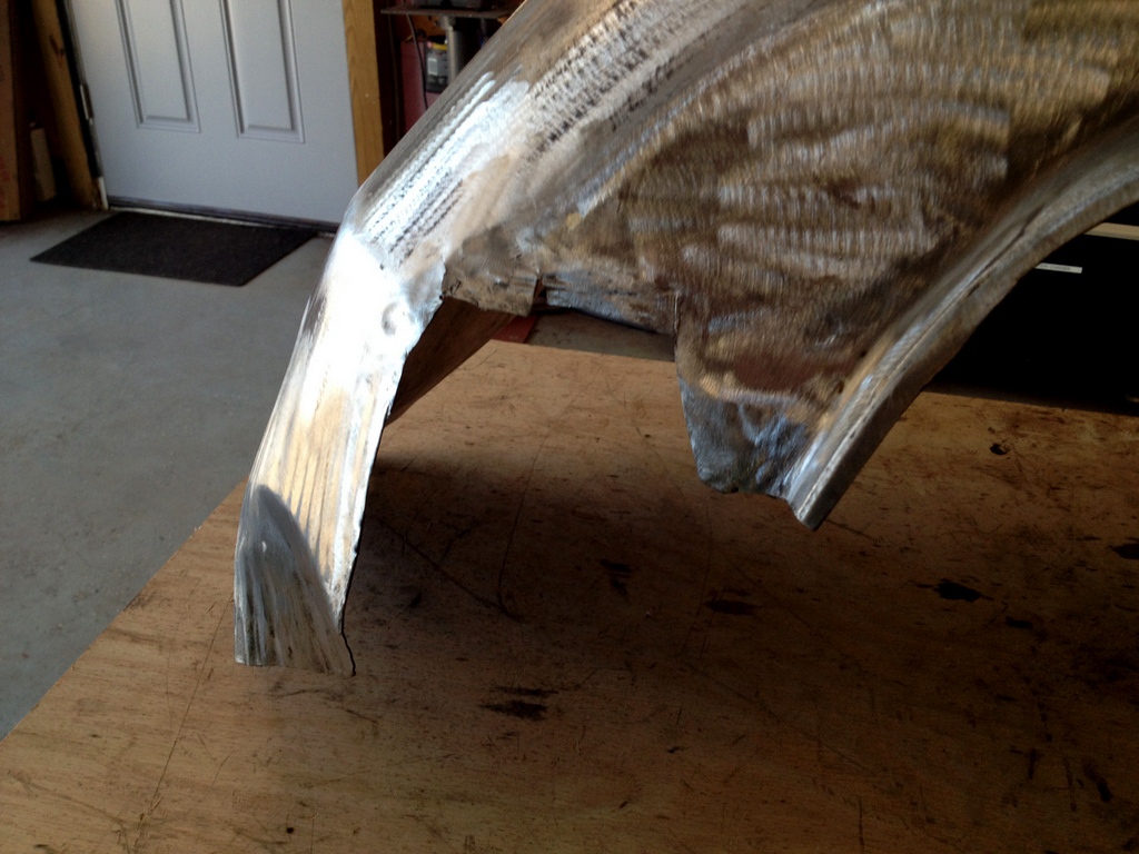

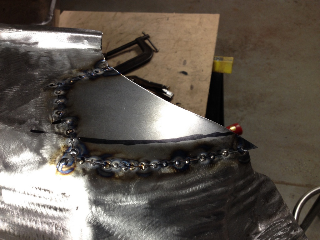

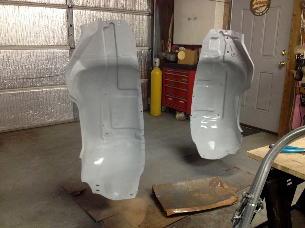

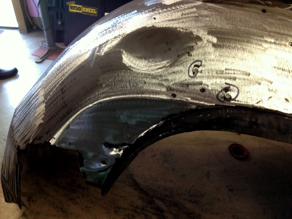

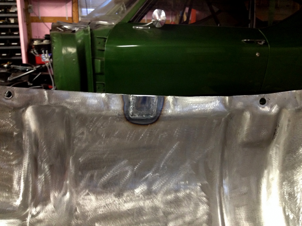

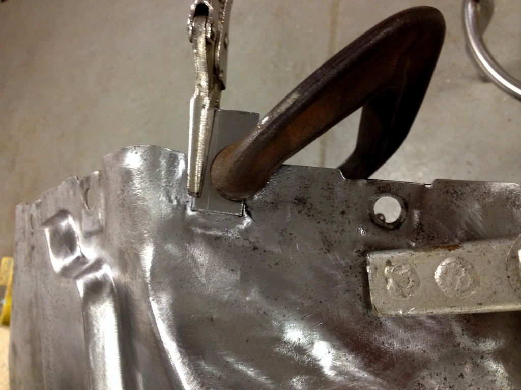

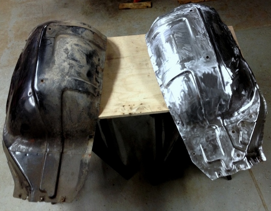

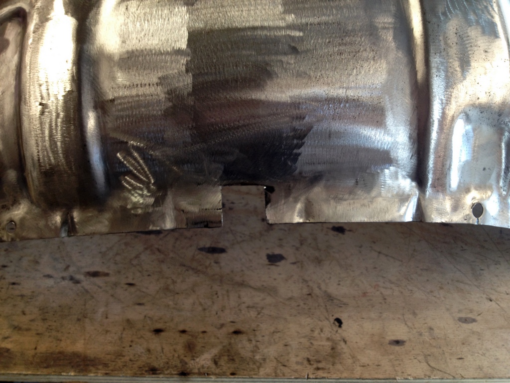

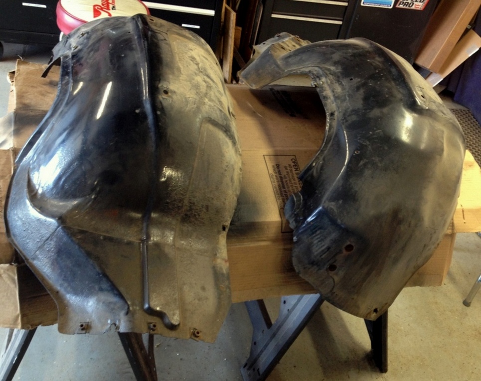

Inner fender resto. Tin snipped out clutch linkage access hole filled. Unused factory installed holes filled. Dimples & dents hammered out. Torch cut off attachment pads, fixed and replicated to be oem like. De-rusted & cleaned. Self etching primer and some satin chassis black sprayed.
ID:	31894   Click image for larger version
ID:	31895   Click image for larger version
ID:	31897   Click image for larger version
ID:	31898   Click image for larger version
ID:	31900   Click image for larger version
ID:	31901   Click image for larger version
