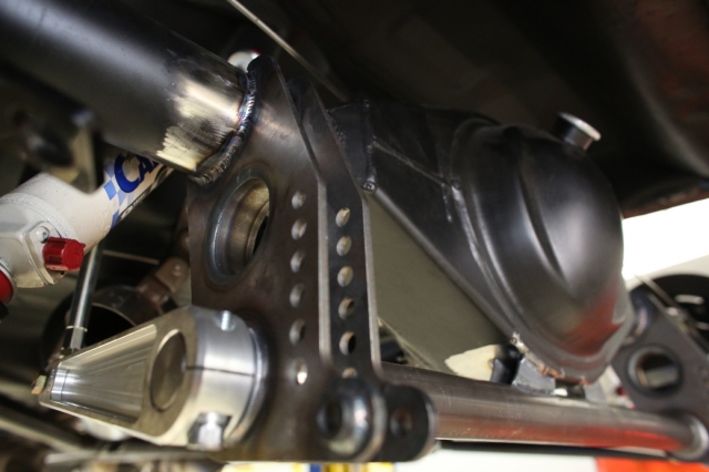

Just read the older post on this subject. And from what I gather from the NHRA tech's comments something like this would be acceptable in a stocker. Ohhhhhh!!! this is one of those insane Camaros allowed to run stock. A tab welded to the housing is acceptable???

Maybe the rules have changed since I did my Firebird but I would say the stuff shown on here is illegal. My understanding is the anti-roll bar must be bolted on to the factory holes in the subframe along with a clamp around the rear housing. Welding of tabs and such is illegal.
I used the bolt on Spohn performance one and it works great and legal. Like I said, maybe the rules have changed but it was fairly clear then....

It's just how you interrupt you the rulebook (in an attempt to take full advantage of the rules) and tech personal that don't know or enforce the rules. The rule book is vague and unclear on a lot of its content. When you try to get clarification and call divisional techs in the country and get different answers depending on who answers the phone. So this is the end result.

That last picture must be of a COPO Camaro since it appears to also have a Ford 9" rear end. The COPO's do have a 4-Link.
