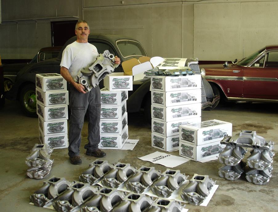

Also, I got the first batch of my single plane 4 barrel 348/409 intakes machined and shipped !
So, I'm finally ordering my new Jerico this week. Looks like I'll go with the 3.19 first gear, running with the theory that I can launch at a lower RPM, and use the engine and the light flywheel to accelerate the car.

Nice looking intakes!
