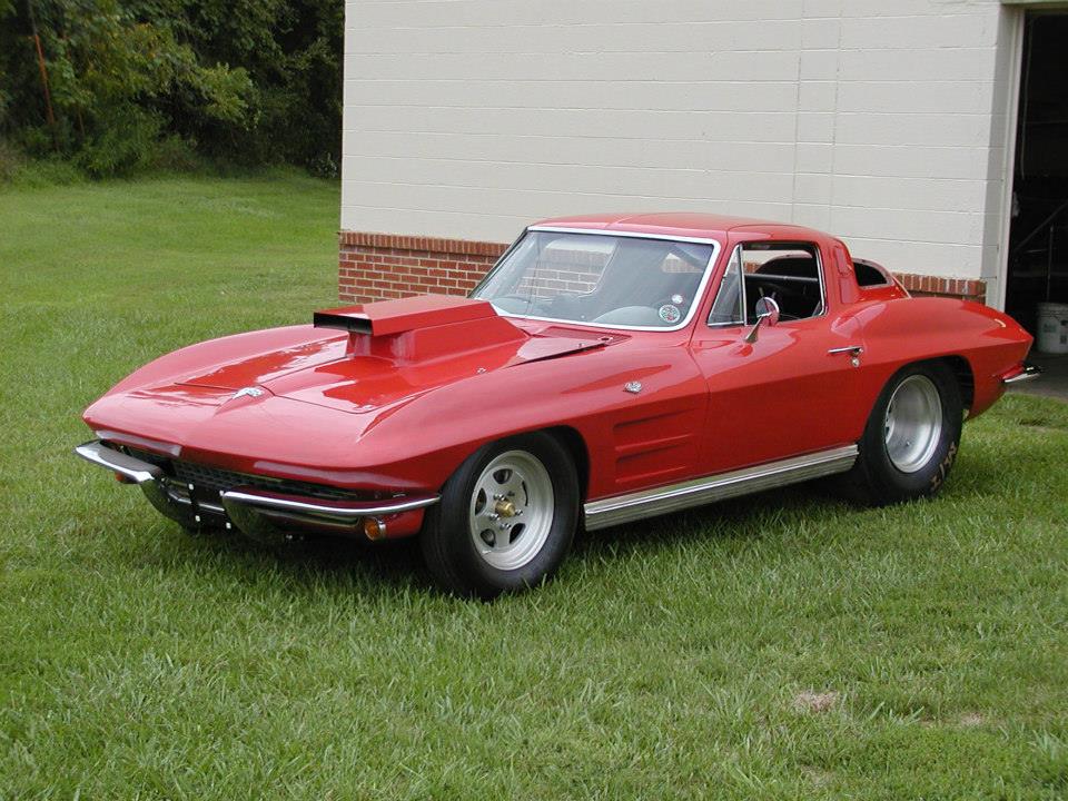

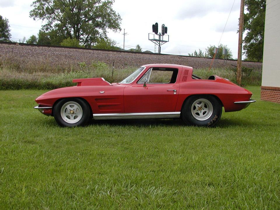

Lynn Engels 64 corvette super stock modified car in the works at Bill Harris Race Cars.
ID:	26442   Click image for larger version
ID:	26443   Click image for larger version
