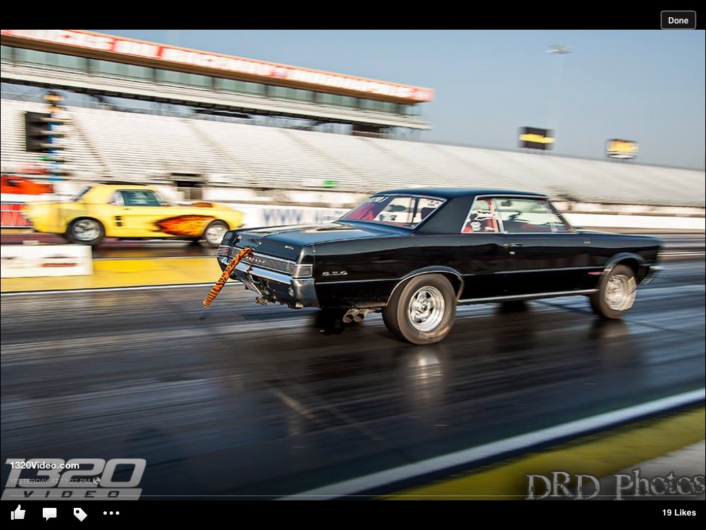

I have a friend with a 1965 GTO stock car that weighs 4050 lbs with a 700hp big block and a tremec with a 4.30 gear what would be a good radial slick?

Location: Genoa, Illinois

Hoosier does in fact make a 9"x30" bias-ply for stick cars. Sorry, I do not have the p/n. However, with a 4,050# car, 700 HP and a Tremac....I sure wouldn't want it to hook to hard!
And why does a '65 GTO weigh so much?

Thanks for the advice, I was running the M/T 3055S which was working OK, 1.51 60', mostly in the 1.55 range. The car is a street strip, even has a hitch, just Got back from Hot Rod Drag week, where I put 5700miles on it, so it has some creature comforts!
The TKO 600 is face plated just as you describe, cryoed, heat treated from liberty plus I have a girdle on the front of it to reinforce the case. 3056st's might be the hot ticket... I will have to wait for spring now! Thanks for the input! |
