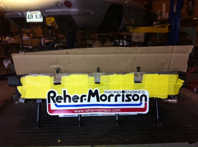

[QUOTE=SSDA Hemi;370786]
And Stephen, if I was you, I think I would be the most pissed off of all. If they ever threw me out at Indy, I would not have the class and composure of Mike Cotten ! All hell would break loose and anyone with bolts out of their heads would have been going home with me at the very least !
NHRA said noting to me at the track. Photographed my R&M stuff with Ray Barton. standing right there. Got a call on the way home from CW asking why I was DQ? I was so POed the car has been in the top of the stacker until last week. About a month later I recieved a letter from NHRA saying to remove (2) 1/4 X 20 bolts that are visible on the head. We have 4?? on each head. Typo or can I leave 2?
Charlie won the race, got paid and has a steel arbor thru the head VISIBLE even with my poor one eye where my bolts are. (Our design is better). Just not faster and now we know why.
I am still waiting for takers on the KKFC challenge. Not a joke, I am serious. "Nip this K&%# in the bud" as we say in the South.
