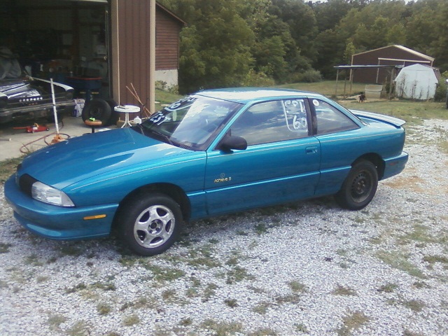

Well FWIW, the drag radials are on my car now. Don't know when I'll get thte chance to get back to the track. My Saturday work schedule is starting up again. So, may be a couple weeks before I can try them out.
