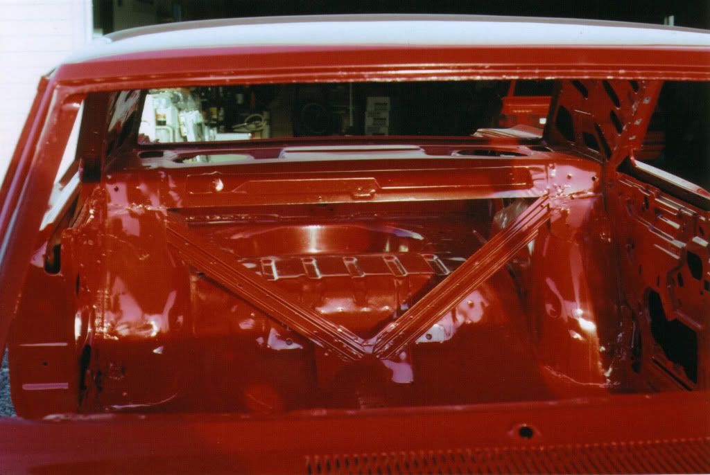

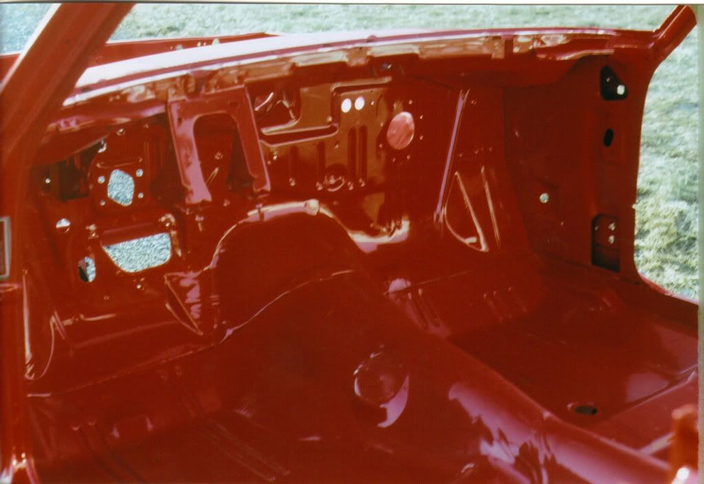

![]() Quote:
I am doing a clone right now and I was wanting to do something like this with the inner wheel tubs. I had heard that the originals were hammered flush to the frame. Is this correct? Could you possibly send me some info or pics on how you did yours? They look great! Sam surelink@att.net |
#1666 | |
Join Date: Sep 2008
Posts: 1,280
Likes: 23
Liked 31 Times in 19 Posts
![]() Quote:
No they were not hammered flush with frame rails from Hurst. They opened the outer quarter openings & installed offset spring hangers, I believe 3/4". Mine are cut down the center, placed against the frame rail & the gap filled with sheet metal liteweight |
