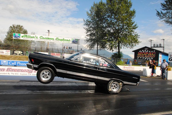

Default Re: controlling wheelstands
Wheelstand... What wheelstand? Looks good to me.
ID:	7797   Click image for larger version
How about a posting a photo of the mustang on the bumper Dale? I missed it in person that day....
