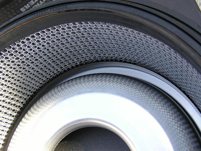

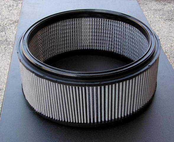

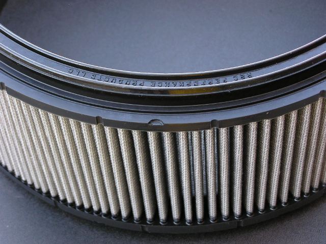

Here are photos of the offset media, Stock/Super Stock filter prototype shown in 5" height. This is synthetic fiber media that does not require oiling. Normal track maintenance is simple using 40-60 PSI compressed air directed from the inside surfaces outward and it's ready to go, race after race. The filters are washable using mild, biodegradable detergents. Efficiency is improved as well. The 4" filter is tested at 1200 SCFM.
Regards,
Ed
Name:	Stock Super Stock Race Filter small file.jpg
ID:	2741   Click image for larger version
Name:	Stock Super Stock Race Filter 044 small file.jpg
ID:	2742   Click image for larger version
Name:	Stock Super Stock Race Filter offset media small file.jpg
