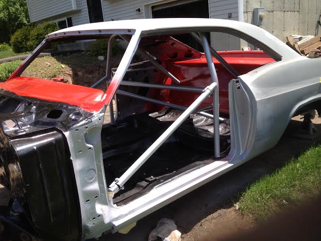

Thanks everybody for your help! New Pic of progress.
Will Lamprecht 65 Impala 396/325 I/SA

Nice swing-out bar!
