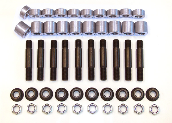

The moser #8080 kit is the answer,same deal as the M-W but cheaper.It comes with 2 sets of spacers,long ones for the bogarts,short for the thicker welds.If you look at the unthreaded center the OD is larger so it fits in the wheel hole.They list it as 3'',but it should work. gsa612
