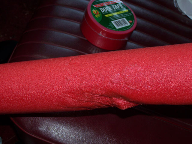

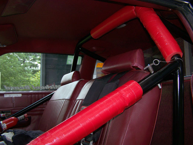

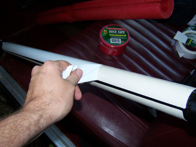

Repainted mine last year with Rustoleum and a regular brush, no primer. Worked great. I used 2-sided tape to position the rollbar padding and keep it from rolling around the bar, and then wrapped it with Duck Tape to protect it.
