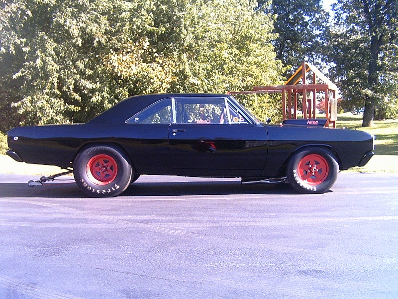

Today - Morgan Family and Friends Motorsports Hemi Dart (former Ray Rixman Dodge)- In August 2015 it will be 40 years since I rescued it from a junk yard!
Dan

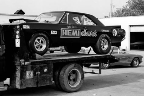

Found on f.b.
