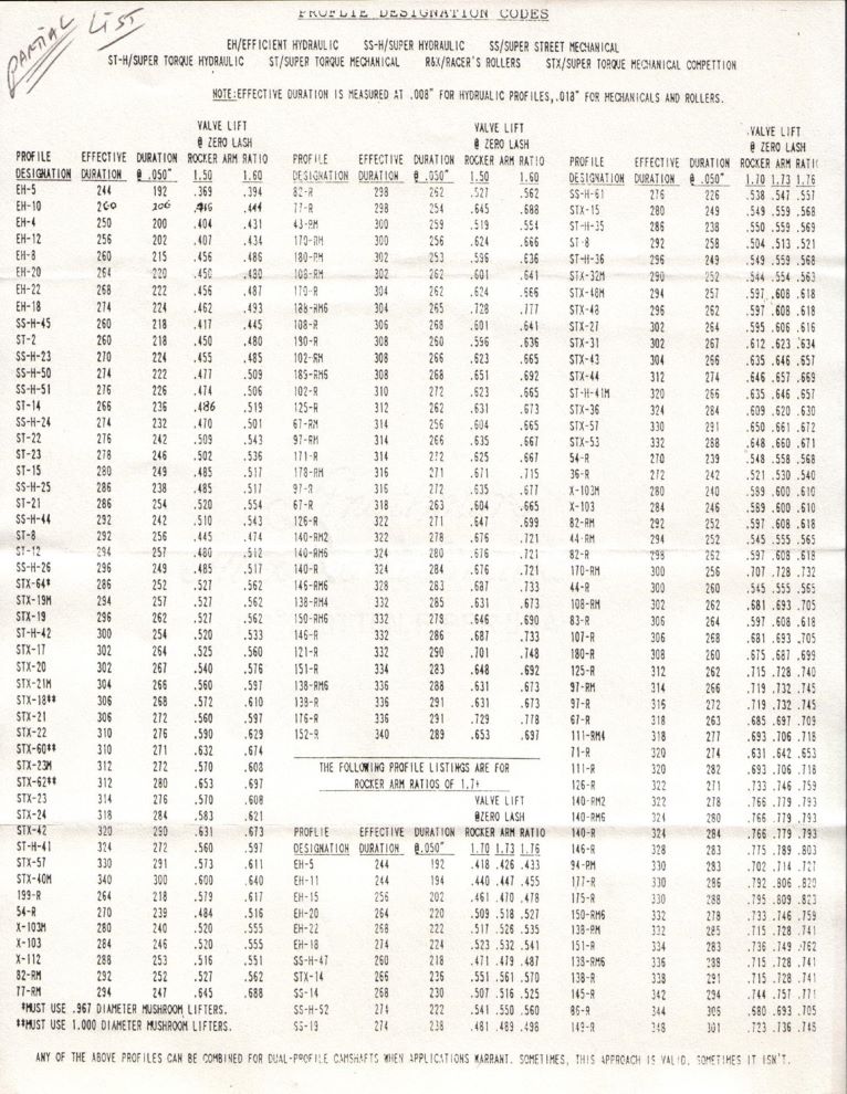

I found this handy chart, looks like older cams but with Advertised and .050 duration. Just lobes, no LSA given.
The 72-R isnt on there & there's no correlation between the cam number and duration. IT does seem like, for the rollers, the .050 duration is about 40 degrees less than advertised, give or take a few.

He said 72-R is 276 at .050", 318 at .018" (advertised), usually cut on LSA=105, kinda rough idle then. He listed .050 lobe events as 35-61-65-31 which is 2 degrees of advance.
Gross Valve lift .599 intake, .580 exhaust which works out to .3815 lobe lift with 1.57 intake and 1.52 exhaust rockers.
So there you go, he did say he can still make that one but could cut a more modern grind too.
