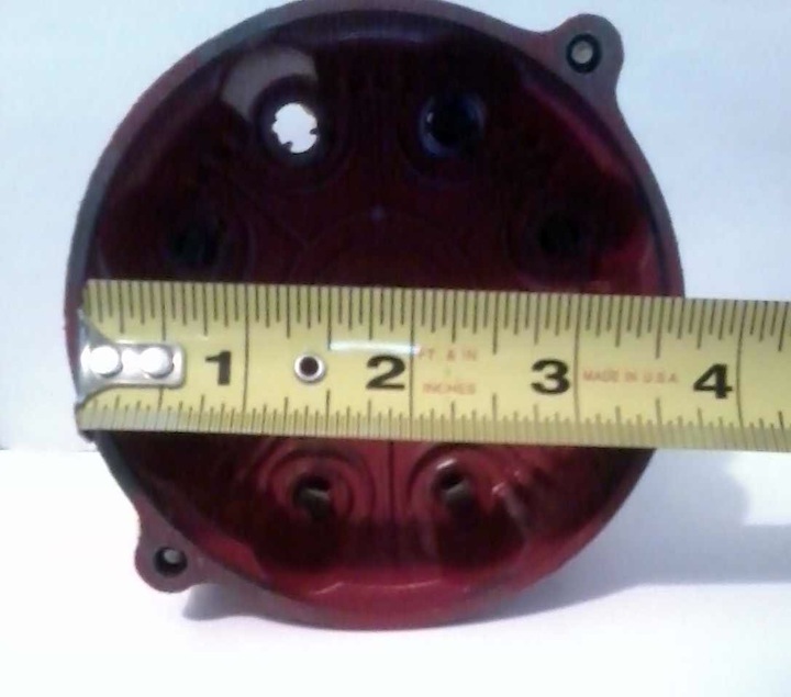

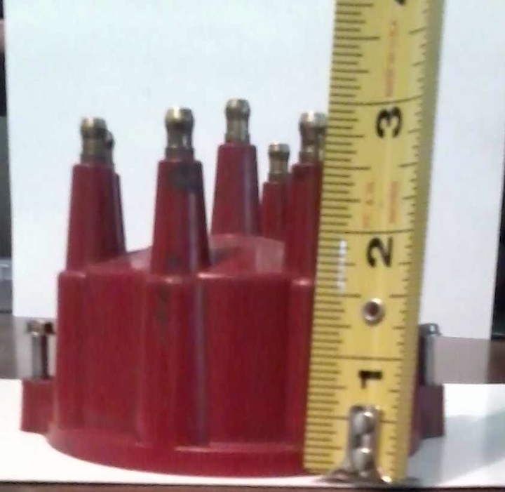

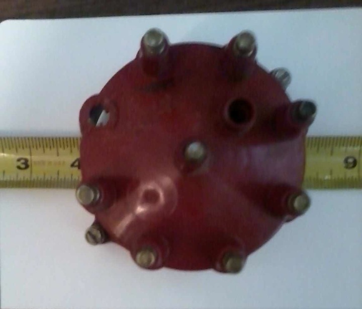

We've gone to several local parts houses and gone through the parts books with some of their "seasoned" personnel and looked at quite a few distributor caps. Some are very close, but all were either a bit too tall or the diameter was off by 1/8 of an inch or more. A tech rep from Accel tried to cross reference the Holley part number with no luck.
Attached are a few pictures of the cap with a broken terminal. The cap measures 3 7/8 inches outside diameter at the bottom of the cap, 3 9/16 inches inside diameter at the inside mounting surface, and about 3 inches tall.
Still looking and willing the chase any lead anyone can offer.

The Mallory 208M distributor cap look an awful lot like that one...
http://mallory-ignition.com/cap-dist...-down-red.html
Hope this helps...

i have the same dist and will need a cap soon, if memory serves me correct its the same as a AMC 8 cyl screw down cap with hei terminals. For some reason im thinkin early 80's jeeps with the 8 cylinders but i cant remember for sure. Theyve been discontinued by Holley years ago, i had one new cap but lost it.
