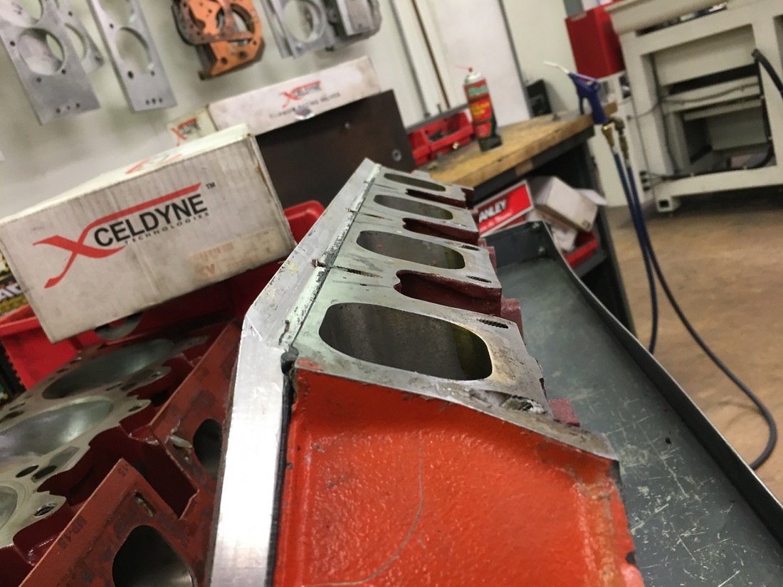

Spyphish
Join Date: Aug 2010
Posts: 846
Likes: 16
Liked 679 Times in 180 Posts
Default Re: Hemi Head Ruling
Originally Posted by David Barton View Post
Our heads are simple. We cut them back as far as we can while keeping the original valve cover and intake bolt holes.
David Barton
#1. David, ya'll keep those in the trailers with the cars or back at the shop? I know, your a French model. Bon Jour
pitoyable
