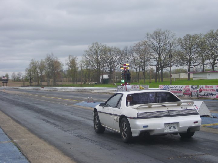

Saw this one day at dragway 42 running mid 17s...
Ron Huntley, Jr. announcer and Half ![]() "Those who can, do. Those who can't, criticize." |
