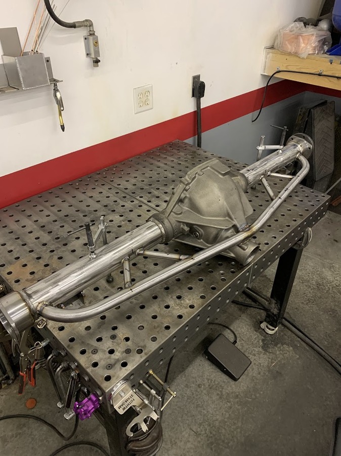

Default Re: Welding tips and bracing of axle tubes for factory 12 bo
Go aftermarket, thicker casting and tubes, weld them all the way around and brace it like I did and you'll never worry about it again.
Don't think ladder bars will go on there real easy...;-)
