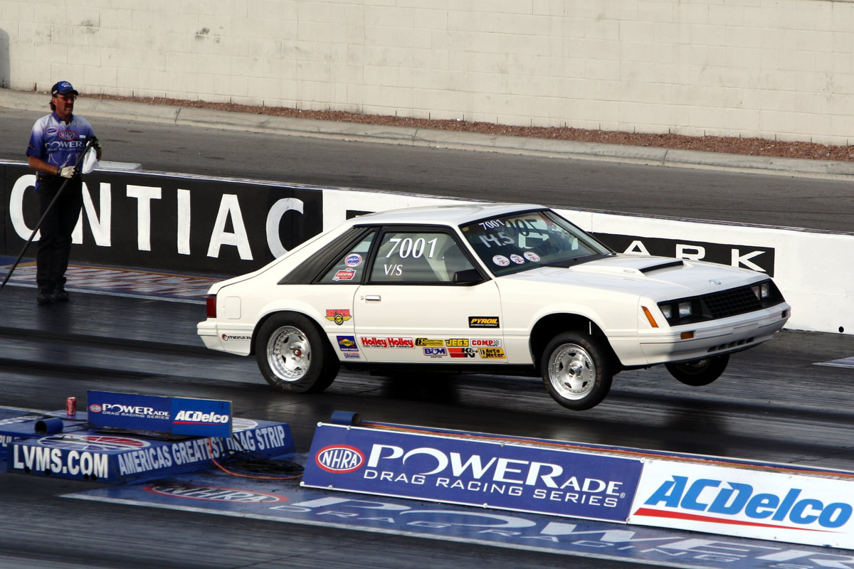

How do these stock and super stockers get so much weight transfer to stand up as far as they do?

Build the car light as possible. Then add back necessary weight over back wheels. 3 speed trans, 5:13 gear, stiff sidewall radial slicks.

Except, if you know what you are doing, you don't put weight over the rear wheels...
3-speed trans don't have anything to do with wheel stands either. There are lots of cars out there with a powerglide that will drag the bumper during the launch.

Some of the wheelie is because of front springs and smooth moving front suspension components. All stockers and most super stockers retain the OE front suspension to employ a tall spring with stored energy.
In addition, in many cases, they use quality, double adjustable shocks.
The Caltracks that many stockers use perform much like a ladder bar and most of the SS cars have a four-link that allows some tuning of the wheelie.
You already know it is not magic, just attention to detail.

If you want to put it on the back bumper, put it at the back bumper. To keep it under control keep it at or near the axle center line
