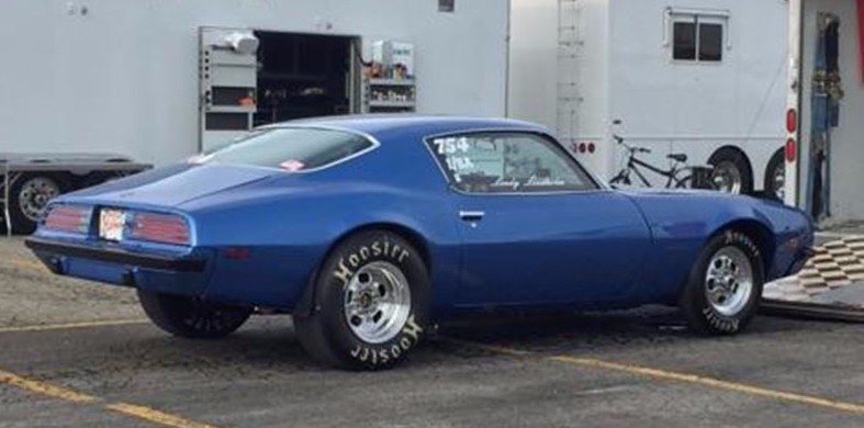

Congrats to Lindy Lindholm for his #1 qualifying position, in a Pontiac powered 2nd gen Bird !
http://www.dragracecentral.com/DRCSt...UMMIT#indextop
Name:	Lindy #1 .jpg

Anyone know what combo is in that '74 Firebird ?

Originally Posted by ALMACK View Post
Congrats on the # 1 spot Lindy !
Pontiac 225hp 400--D-port heads--iron intake--750 Q-jet
http://www.nhraeventreg.com/ListEventCatgs.asp?
ey=2017&ec=PC1&cc=8&rn=1
Well, it appears that link no longer works. It was a Winternationals pre-entry list, showing that Lindy claimed a Pontiac 400 engine.
http://www.classracerinfo.com/Engine...1&MAKE=Pontiac
The Class Racer Info site lists that 400 Formula weight @ 3564, with an hp factor of 275. I calculate that to be a 12.96 weigh/hp ratio. So, if I understand the rules correctly(that you can run your natural class or go up or down 1 class, by adding or removing weight), that combo can run I/SA, J/SA, or K/SA.
Looks like 12.50 x 275 = 3438lbs would be the min weight for J/SA. And 13.00 x 275 = 3575lbs would be the min for K/SA. But he's running I/SA, so he weighs less than 3438, according to my math.
By adding weight, I think he could run a D-port 455 in I/SA. hp factor is 306. Weight is 3572. 12 x 306 = 3672. So, looks like it would make I/SA by adding 100lbs.
http://www.classracerinfo.com/Engine...2&MAKE=Pontiac
http://www.classracerinfo.com/Engine...px?ENGINE=2092
http://www.classracerinfo.com/NHRA_Classes.aspx
But, I'm certainly no expert. So, if some of you guys who don't mind, if my calculations, or any of this info, is wrong, please correct it. Since I'm not savvy to all the rules, I'd like to know the details of how to figure all this correctly. Thanks !
Would assume he's running a TH200. But could be a light TH350, I reckin. Don't know.

You forgot to add the 170 pounds for the driver weight.................
I/SA = 3470 pounds
J/SA = 3607 pounds
K/SA = 3745 pounds
Bob

"You forgot to add the 170 pounds for the driver weight.................
I/SA = 3470 pounds
J/SA = 3607 pounds
K/SA = 3645 pounds"
OK, thanks !
So, that means that if the driver weighs more than 170, the car can weigh less. That way, a jockey weight guy will not have an advantage over a big guy. It makes sense.
