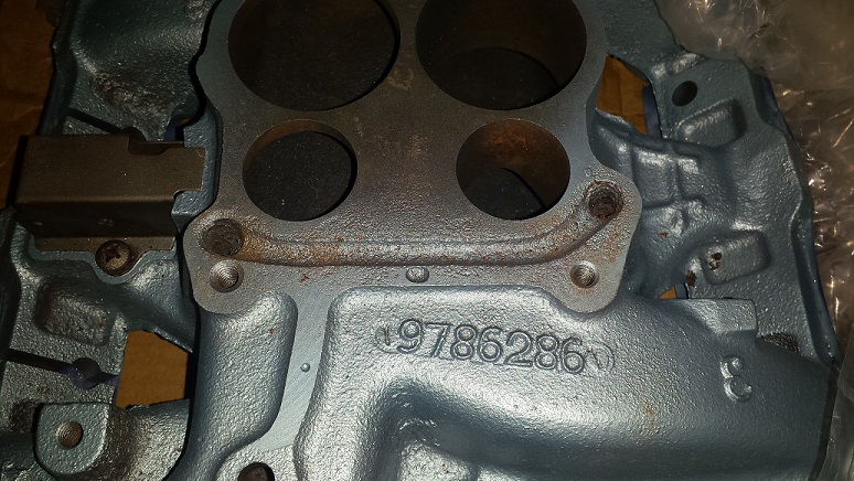

What about blocking the small exhaust holes under the front of a quadrajet on the 67 only Pontiac intake?

You can do that by getting a different carb gasket . So there won't be any modification to the manifold . Those passages probably don't do much if you filled the exhaust crossover ports in the cylinder head , which is a legal modification .
