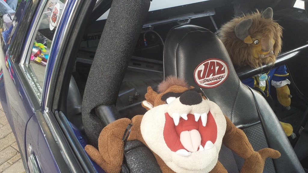

Saw this installation at a cruise night. Pretty scary.
On a car where the factory gas tank is the trunk floor, do they require you to install a metal barrier?
Name:	Fuel Cell 20150610_194151.jpg
